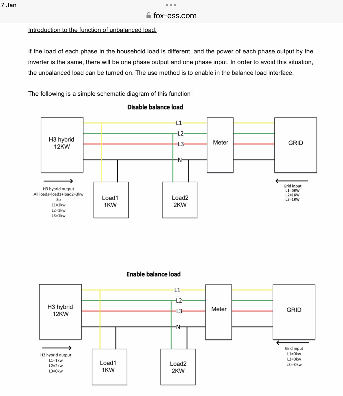

I see that Foxess has a PRO inverter where they advertise that triphase can be unbalanced. How about the normal inverter can it also handle unbalanced triphase load ?
Thx you for your time.
Posts: 1623
The Fox H3 inverter is also able to be configured to work with unbalanced loads, see attached operational description from the H3 manual.
The maximum power it can output per phase is 1/3 of the inverters total output power i.e. an H3-15 inverter can output a maximum of 5 kW on each of it’s phases.

Yes the H3 pro can do it...I was asking about the non pro inverter 12Kwh
Posts: 1623
cdsgames wrote: Tue Jan 28, 2025 8:38 am Yes the H3 pro can do it...I was asking about the non pro inverter 12Kwh
That's what I said
The Fox 'H3' inverter is also able to be configured to work with unbalanced loads, see attached operational description from the 'H3' manual.
