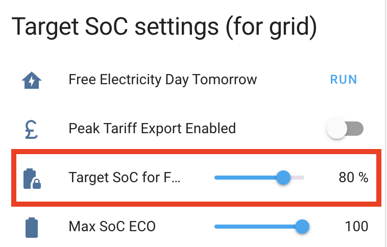

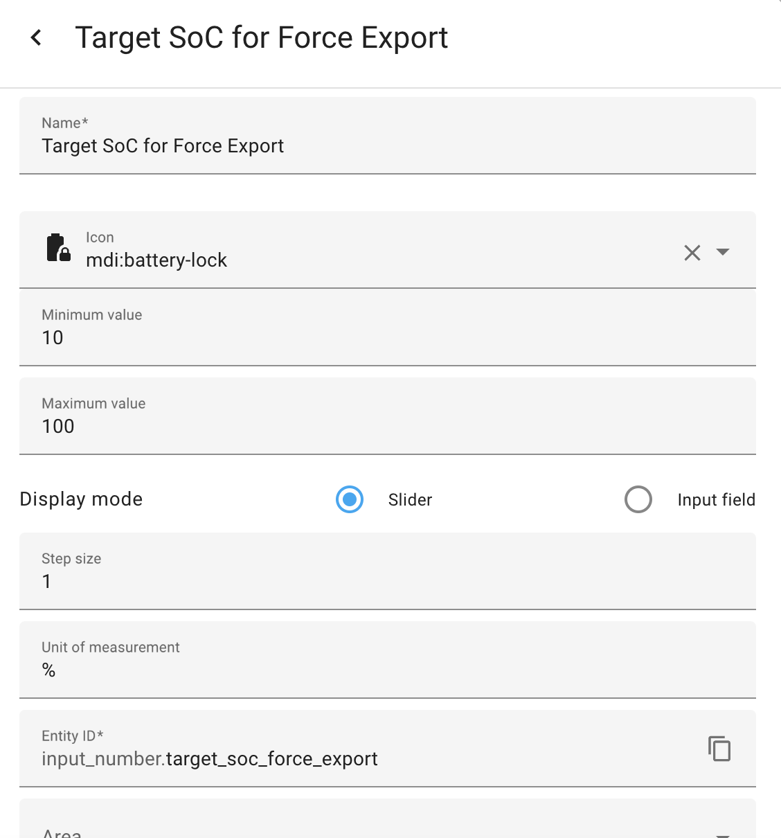

Not saying this is more correct, but I have something similar working during summer when I set mode to Force Discharge at peak rate. It's also making use of a
Code: Select all
input_number.target_soc_force_export
created as Settings > Device & Services > Helper tab, which allows playing with the value from the UI
and added to a dash
My automation below (looking at again could be neater with a condition on time like you have done with the _sun_) but note the action works setting mode like this
