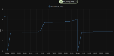

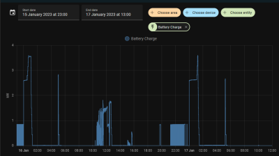

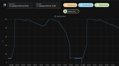

I've recentlly added 2 additional HV2600's on top of my existing 2 HV2600 but noticed that it only seems to continue charging as if theres only 2 total, not the 4 currently connected.
Setup (in physical order)
- BMS v2
- HV2600 v2
- HV2600 v2
- HV2600 v1
- HV2600 v1
Other info
- DIP switch = 2
- Voltage around 210v
- Inverter = H1-3.7-E
- Original bat SOC was around 50% before adding the additional 2 bats
- Force charge is between 00:00 to 05:30
Happy to give any extra info if it helps!
My next idea is to only have V2 bats hooked up, force charge them to 100% then do the same with the V1's. With that i hope the system can see all 4 bats are at 100% and will perform as expected but i figured i'd ask you wonderful folk first!
Graph on the SOC value over the last 2 days
Graphs on live (5 second pol) usage in kwh
Graphs on total daily charge
Battery Charging issue after adding 2 additional batteries

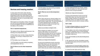

Fox do give the advice that if you’re seeing the SoC jump rapidly 30% or so, it’s best to split the packs into pairs and charge each to 100% - but before you do that you should try force charging from grid to 100% discharge to 10% and repeat that cycle a few times for the BMS to work out the battery pack limits, it can take several weeks for the battery capacity to report correctly and it will also help with any battery imbalance.
Last thing to add is watch the temperature as the battery stack will be well below it’s rated capacity with the temp below 15C, i’ve added the Fox advice on temperature affects for your info.

Foxess updated the app late last year as a result of the low temps and the complaints they received, they updated some of the specification sheets to show that whilst the batteries might operate to -10C, they likely wouldn't charge below 0C (sustained) - the info I posted is courtesy of William Eccles who used his test system to generate the error from his app and this is the information the app provides.

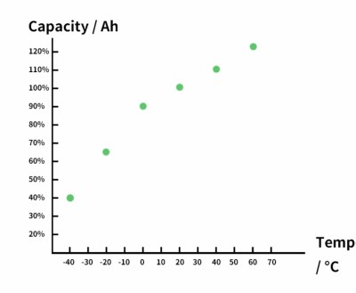

This is a complex area, as the battery temperature you see on the Fox charts is taken from a sum of all the temps in the cells of your battery stack - equally the battery temperature probe is actually inside the battery pack on the cells and so it always gives a higher than ambient reading (in my experience about 6C higher), and of course when the battery charges the temperature rises rapidly because the probe is right on the cell itself - the rapid rise is entirely normal but this temperature is normally used by the BMS as part of it's charging and battery health.asyrop wrote: ↑Tue Jan 17, 2023 11:10 pm
I have seen the various temperatures recorded for my system on the Fox cloud data, but none showed temperatures close to freezing and yet the battery definitely responded to the cold as your attachment describes. Do you know which parameter is determining the limitations to charge and discharge currents ?
Also I am concerned my (new) batteries may have suffered with now reduced capacity. Do you have any information on how they should be calibrated and the rated capacity confirmed ?
All LFP batteries are tested at an ambient temperature of either 25C or 40C depending on the test - the Fox batteries quote their battery capacity at 25C and so you should use ambient as the best metric - the capacity drops slowly below 25C and starts to accelerate below 15C. This next graph isn't based on the Fox battery but is typical of similar LFP batteries when tested which might prove helpful. Personally I try to keep my battery ambient above 15C (using an insulated enclosure), it gives better capacity but most importantly none of the unfortunate charging side effects of colder batteries.
It's very important to point out that cold temperatures don't damage the batteries, the effects last only as long as the cold temperatures - the batteries soon bounce back when they warm. Unfortunately if the batteries get very hot they can be damaged and their life will be reduced (which is why insulated enclosures are not recommended in warmer months), the LFP batteries used by Fox in solar systems are capable of operating beyond 50C.
Perhaps also worth pointing out that temperature effects all types of battery chemistries in one way or another, however the LFP batteries used by Foxess are an excellent choice for long life, and they are very tolerant to a wide temperature range.
