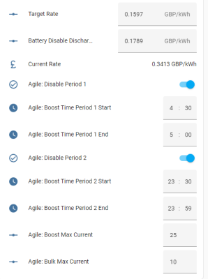

Hi all, I use Agile & have several automations that help me manage the Tariff. Bear with me as I am dyslexic & writing is not one of my strengths, but I'll do my best to explain what I've done & feel free to ask questions but I'm on a course this week (WC 8th Jan), so may not be able to answer straight away. Also, if you have any suggestions please feel free to mention them as I only know the basics around writing automation.
You'll need the FoxESS Modbus & Energy Management integrations installed as my automation targets some of the options contained in their code.
I've attached a screen shot of the main helpers I have on the dashboard to control the automation. For example, setting the target price to charge when below the price and time periods to boost the charge current when prices are low or negative. Rinse & repeat the automation & helpers on the time/max charge current if you want more periods where you charge higher than your usual charge amps.
It's a bit clunky & does require a little maths every day to work out how many 30-minute Agile segments to target that will charge the battery, taking into account how much charge is in the battery & how much solar charge you'll get the next day. I typically have my battery charging at 10 amps, but I have added a couple of time automations that can be used to ramp up the charge amps and then revert to whatever amps you want as a bulk charge. Useful when the price is very low or negative.
You'll need to know how to set up helpers (plenty of videos on YouTube that can help with that). Also, an integration that can import Agile prices. I use this one https://github.com/BottlecapDave/HomeAs ... opusEnergy
Below is the automation code that charges the battery when the current Agile price is below my maximum import/target price. Battery Disable Discharge is an automation that puts the inverter into Backup work mode. I add 12% to the highest 30-minute import price to account for charge/discharge losses. Meaning the system runs off the grid if it's cheaper than using the stored energy I paid to put into the battery (not perfect I know, but at least I'm not using the battery when it's more expensive than using the grid).
