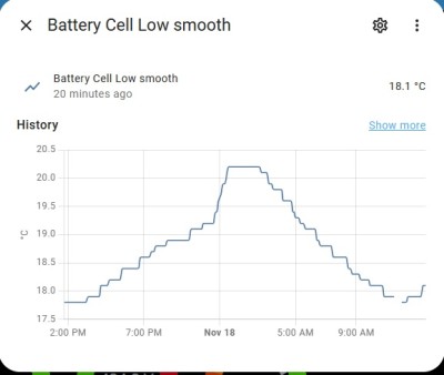

10 days for sensor data is default for HA using the sqlite database, but long term statistics such as your energy dashboard retain history indefinitely.
If you switch to a reasonable size SSD you can increase the days you keep sensor data to 60 even 90 but as you have a lot of sensors reading every few seconds it will bloat the database out very quickly.
Where I need to keep longer data I create a template of the sensor i'm interested in, and either pass it through a filter to slow the update frequency
Code: Select all
  - platform: filter
    name: "Battery Cell High smooth"
    entity_id: sensor.bms_cell_temp_high
    filters:
      - filter: lowpass
        time_constant: 4
        precision: 1
which still gives you a reasonable representation of the value

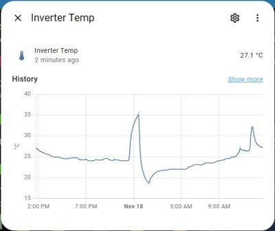

or use a template with an update interval specified, this one only updates every 5 minutes which saves a lot of space in the database.
Code: Select all
  - trigger:
      - platform: time_pattern
        minutes: "/5"
    sensor:
      - name: "Inverter Temp"
        device_class: temperature
        state_class: measurement
        state: >
            {{ (states('sensor.invtemp')|round(1,0)) }}
        unit_of_measurement: '°C'
This still gives a good idea of what the sensor is doing at 5 minute intervals
