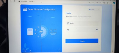

all I see is:
like I said it all seems to be working fine but I've lost visibility on the app (phone and PC!) as the dongle is not communicating...

ok thats not a Fox screen, probably a router or something similar on your home network,
Make sure on the device you are using that you forget any network connection it has to your normal internet router, because the Fox datalogger doesn’t have an internet connection your device will likely be switching away from it to your local network.
Once you phone/tablet is no longer connecting to your router, it should go through the process normally and you’ll get the Fox screen when you enter 192.168.1.1

thank you for responding. I have used a friend's laptop that was never connected to my home's wifi! forgotten all saved networks and only connected to the dongle (that double checked as the network was not available when I removed the dongle ftom the inverter... )...
the laptop shows the same with a bit more imaging...
I know that this doesn't look like a Fox Screen (as it is not featuring in any of their official guides either) but I swear that is what I get!!!
maybe it is their latest firmware model or something (i only installed my system last week!) ... I don't know...

Ok that looks it could be the new smart datalogger, i’ve not seen one before try admin, admin to login
Then go to the Network configuration, and wifi configuration screen

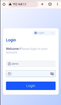

Hi All, been having the same issue with much wailing in despair etc...
Just got WiFi network changed over and working via the below process:
- Connect to the dongle via its "W-xxxxxx" network:
- Password: mtmt2020
- Enter IP 192.168.1.1 in a browser as per other guides.
- If presented with the login page as per the OP:
- Login: admin
- Password: 12345678
This gets you into a small config area where you can setup your new SSID and password. Make sure to 'Submit' each change and give it a moment or two, it was a little slow to register the new details for me.
I found instructions for this in the attached WiFi dongle user manual. This manual can also be obtained by scanning the QR code on the REVERSE of the dongle itself. Don't ask how long I was going in circles before I thought to look on the back of the unit for more details...
