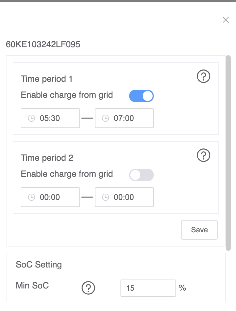

Just had my new system installed
Kh10 Invertor with 20KW battery . I have PV grid connected but none direct to the invertor as yet.
The Battery came with circa 45% charge but with during the day not understanding the set up i manage to discharge to 16%.
I have tried setting a schedule charge from grid but nothing has happened.
i'm sure its something i have changed and sure there will be other issues as i slowly get my head around its setup and operation.
any help much appreciated

issues solved, the Grid supply breaker to the Invertor had tripped. All seems to be working with the charge schedule
- Posts: 1148
Ok, but keep a close eye on it - it might need to be changed for a larger MCB (63A) or RCD value (100mA)martint007 wrote: ↑Sat Sep 14, 2024 8:53 am issues solved, the Grid supply breaker to the Invertor had tripped. All seems to be working with the charge schedule
