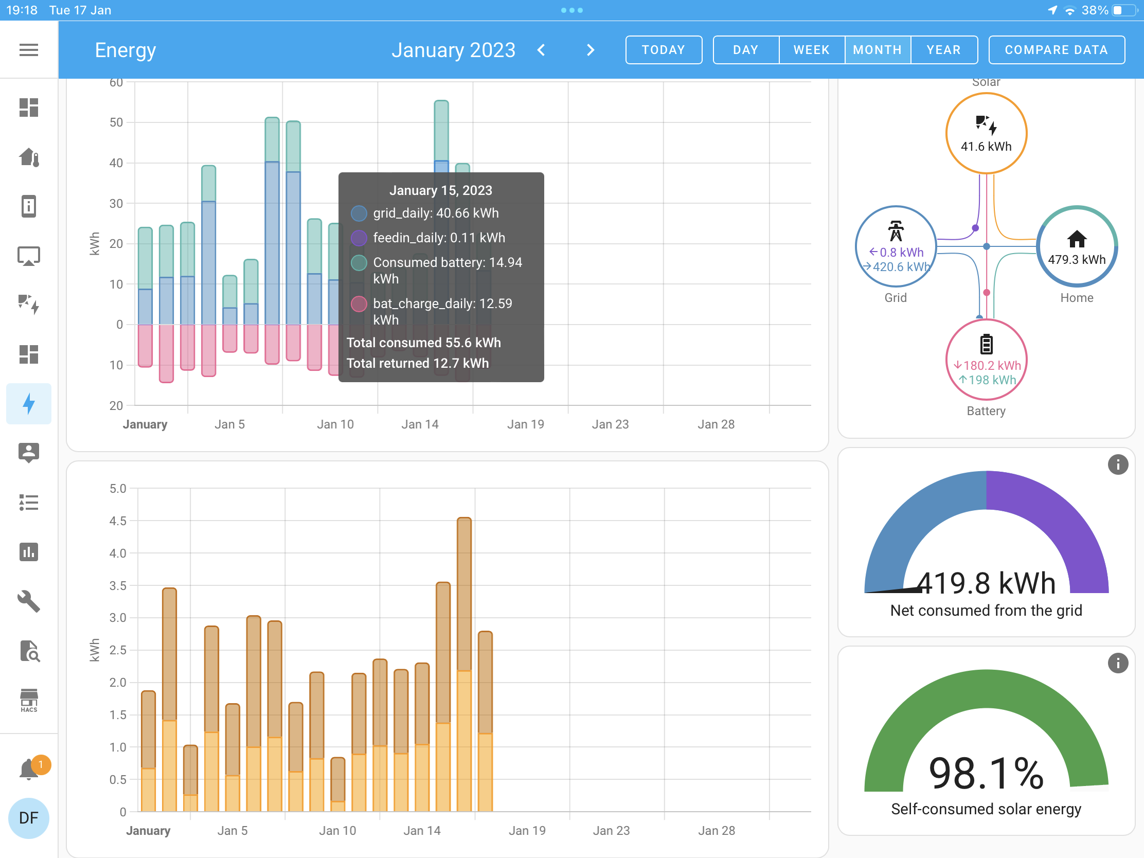

It isn’t easy to work all these things out from the Fox statistics, I use a Home Assistant wired into the inverter to give me almost real time statistics, most importantly it allows me to calculate daily system losses - so for example my system today at 6.30pm i’ve had 3kw of solar, my battery has charged off grid 10.94kw, has discharged by 8.84kw and the total system losses for all of that are showing as 2.93kw.

I know it’s frustrating but I would highly recommend looking at a home assistant which is basically a small micro computer such as a Raspberry PI, they are very good at doing real time calculations, providing statistics and lots of other things - i’ve included a screen shot of mine below, it takes all its information from the inverter itself either by connection to the Fox cloud (which gives 5 minute resolution) or by direct connection to the inverter (which gives near real time) - there are quite a few experts on the forums and William Eccles has done some brilliant setup videos to guide you through.

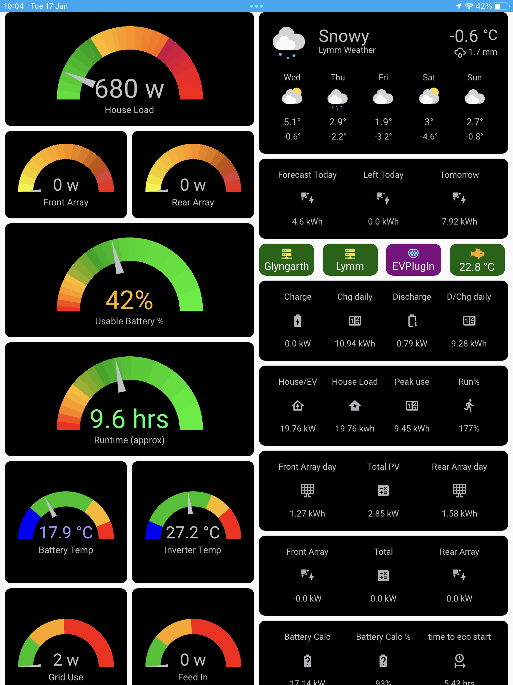

Thanks, it's actually quite an old dashboard that one - home assistant is very addictive and you can "will :) " spend a lot of time perfecting it.
Most of the sensors there are standard Foxess modbus sensors, and using the standard gauge card and custom button card - with the standard gauge card i've gone to the trouble of defining segments (rather than just red, yellow, green) - it shows a finer resolution and I think looks better, i've posted a sample of a card below to show you it's yaml - but if there are any sensors there you are interested in, or have an idea for them - just post it here and i'll do what I can to help.
This is the gauge code, it uses a template sensor that takes the standard load_power sensor and converts to watts (see below)
type: gauge
entity: sensor.house_load_w
min: 0
needle: true
segments:
  - from: 0
    color: rgba( 0,225,  0,1)
  - from: 500
    color: rgba( 0,215,  0,1)
  - from: 1000
    color: rgba( 0,205,  0,1)
  - from: 1500
    color: rgba( 0,195,  0,1)
  - from: 2000
    color: rgba( 0,185,  0,1)
  - from: 2500
    color: rgba( 0,175,  0,1)
  - from: 3000
    color: rgba( 0,165,  0,1)
  - from: 3500
    color: rgba( 0,155,  0,1)
  - from: 4000
    color: rgba(255,185,  0,1)
  - from: 4500
    color: rgba(255,175,  0,1)
  - from: 5000
    color: rgba(255,165,  0,1)
  - from: 5500
    color: rgba(255,155,  0,1)
  - from: 6000
    color: rgba(255,145,  0,1)
  - from: 6500
    color: rgba(255,135,  0,1)
  - from: 7000
    color: rgba(255,125,  0,1)
  - from: 7500
    color: rgba(255,115,  0,1)
  - from: 8000
    color: rgba(255,105,  0,1)
  - from: 8500
    color: rgba(205, 0, 70,1)
  - from: 9000
    color: rgba(215, 0, 60,1)
  - from: 9500
    color: rgba(225, 0, 50,1)
  - from: 10000
    color: rgba(235, 0, 40,1)
  - from: 10500
    color: rgba(245, 0, 30,1)
  - from: 11000
    color: rgba(250, 0, 20,1)
  - from: 11500
    color: rgba(255, 0, 10,1)
theme: AMOLED Blue
max: 12000
unit: w
And this is the template sensor that does the conversion -
      - name: "house load w"
        unit_of_measurement: "W"
        state: >
          {% if (states("sensor.load_power")|float(default=0) * 1000) <=1 %}
            {% set hlw = (states("sensor.house_load_w")|int(0)) %}
            {{ hlw|round(0) }}
          {% else %}
            {{ (states('sensor.load_power')|float(default=0) * 1000)|round(0) }}
          {% endif %}
