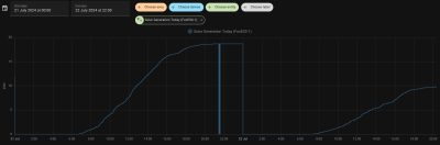

You can see all of the sensors that the integration is providing by clicking on Settings, Devices & Services, find the Foxess-Modbus integration and click on '1 Device'
That will list all available sensors, if you then click on the one that says 'Solar Generation Today' it should open a history graph on the screen.
There's a link in blue that says 'show more' and when you click that it will change to allow you to enter a start and end date/time range - if you pick a day where you know it has done it and set the start date/time an hour before, and the end date/time an hour after and click on the select it will draw the graph for that period of the Solar generation sensor, can you screen shot the graph and attach it below please so we can see what the sensor is doing.
Re: What's with the spikes??
Is that what you need??

Looking at the trace, I think that would cause trouble when the inverter is shutting down once there isn't enough solar left to keep the MPPT up.
It looks like the trace is going up and down several times, I assume as the inverter is detecting enough voltage threshold to start up, before it then shuts down again - each one of those to zero and back to positive will result in the energy dashboard think you've just had a load of solar power.
The state_class of the sensor is total_increasing, so a lower state (even from e.g. 10 to 9) will be interpreted as a reset of the sensor, HA will think the sensor has been reset to 0 and then increased to a new value again. The long term statistic will then use the value it was plus the value it now is and that means because the sensor has gone to 0 temporarily, it will double when it returns to the correct state.
If the sun goes down quickly it won't happen, but most importantly once you have batteries fitted the hybrid will never shut down as it stays operational from the batteries.
