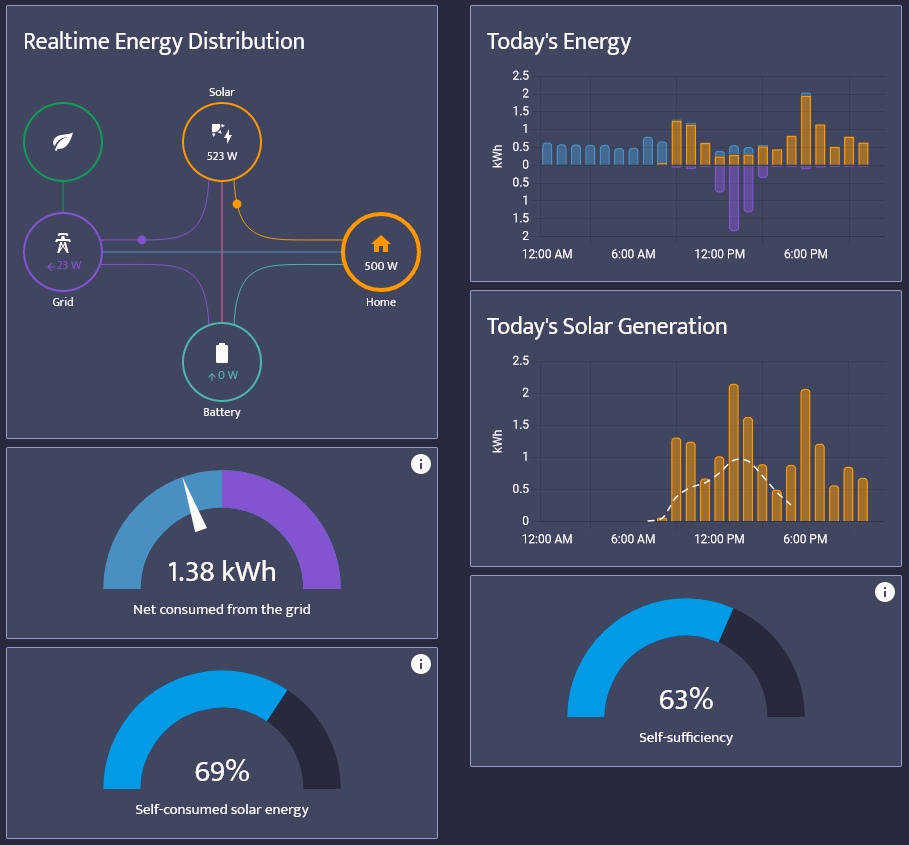

Thank you very much for your response. Yeah, it is a shame they won't give me access, but understandable. I have set up a Shelly EM with two metering clamps. I have one set up on the grid feed-in to the switchboard. The other one is set up on the solar breaker. This is giving me somewhat decent readings but it is also limiting.
It is currently 11:15pm and the sun has long since set. I can see however that I am getting 500w of power from the solar, which I would assume is actually coming from the battery. Hopefully the Fox ESS cloud will be able to fill in the blanks.
Thanks again for the information.
