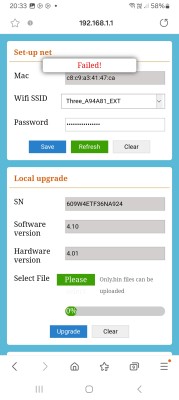

Hi can anybody give me some advice to connect WiFi to get inverter online and how to connect inverter to fox 2 app on phone. I have followed instructions ver 1 upto part 3 configuration OK Then when I go onto app I ant get any further. Thanks Gary

ok, thanks for that - it does appear to be failing to join the network, I guess you've double checked the obvious things like the password is precisely as set i.e. O not 0 (zero) and there are no full stops anywhere in it etc..
The only other thing I can think of is , some it gets confused with some routers / extenders as they have both wifi bands (2.4Ghz & 5Ghz) on the same SSID - the datalogger can only connect to 2.4Ghz - if possible can you try and disable the 5Ghz band or rename it so it has a different SSID to the 2.4Ghz band.
I have installed one of these https://www.amazon.co.uk/TP-Link-Extend ... B08V5J8MMT and it is rock solid, it's configured with it's own wifi name 'inverter', i've disabled the 5Ghz band and it's only used for the inverter - but it just connects up to my wifi mesh using WPS so if I ever change anything I don't have to modify the inverter datalogger settings.

Hi Dave
I have managed to get the inverter and data logger onto my cloud 2 app first go today. I have tried loads of times to get the WiFi on line with no luck it initializes ok but fails to save. I have tried on a laptop with Google chrome and Microsoft. The inverter is in a building 30mts from my house so I have installed a tp link external wifi ariel which is only 2.4g. I have checked all the passwords and they are OK.

- Posts: 1303
Hmmmm, confusing.
So just a couple of thoughts - have you tried connecting your phone direct to the extenders wifi to prove it can accept a connection and give internet access
and the only other thought would be to simplify the name of your wifi extender and remove the '_' characters - i've never tried it with anything other than normal alpha characters and whilst it's clutching at straws it might be worth trying it to discount it.
