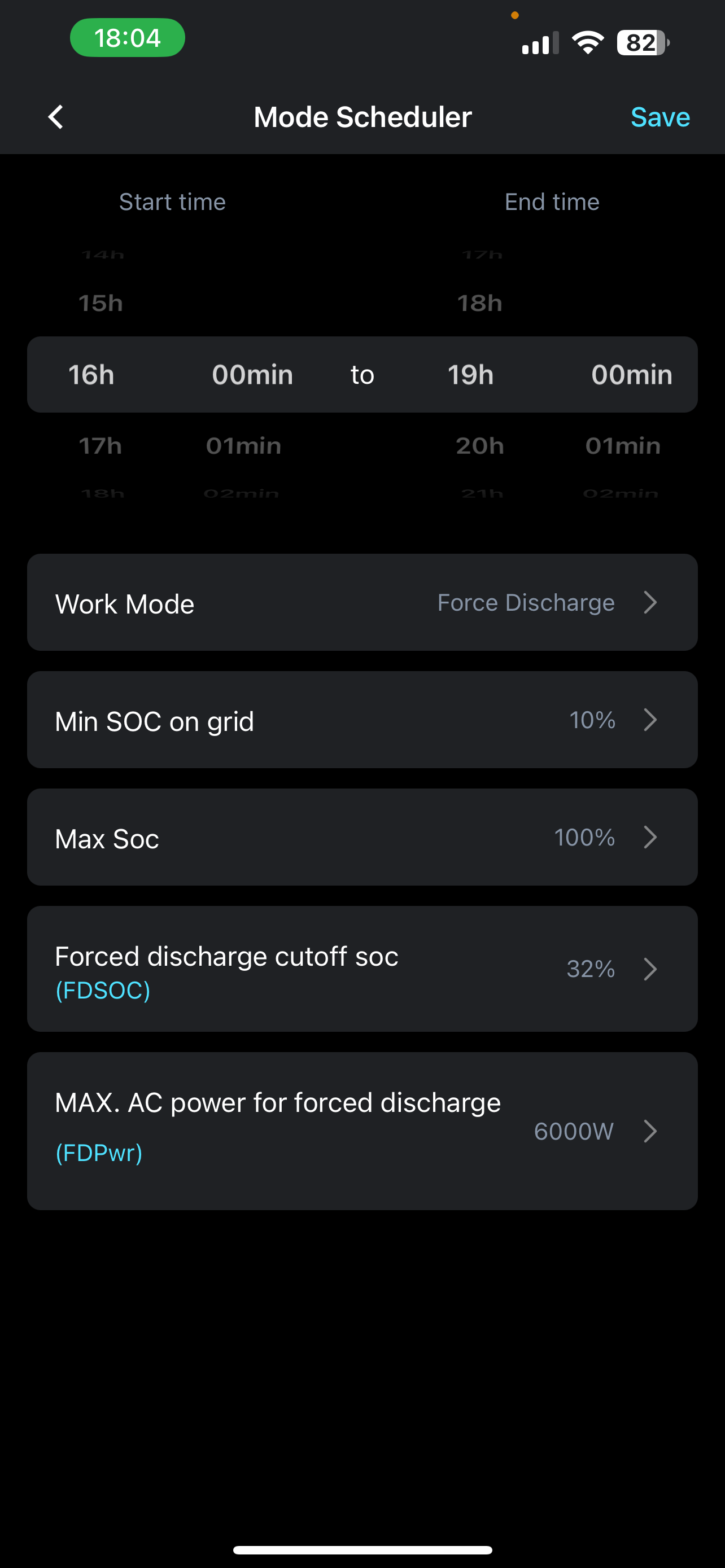

Battery is charging after force discharge during peak flux.
- Posts: 1786

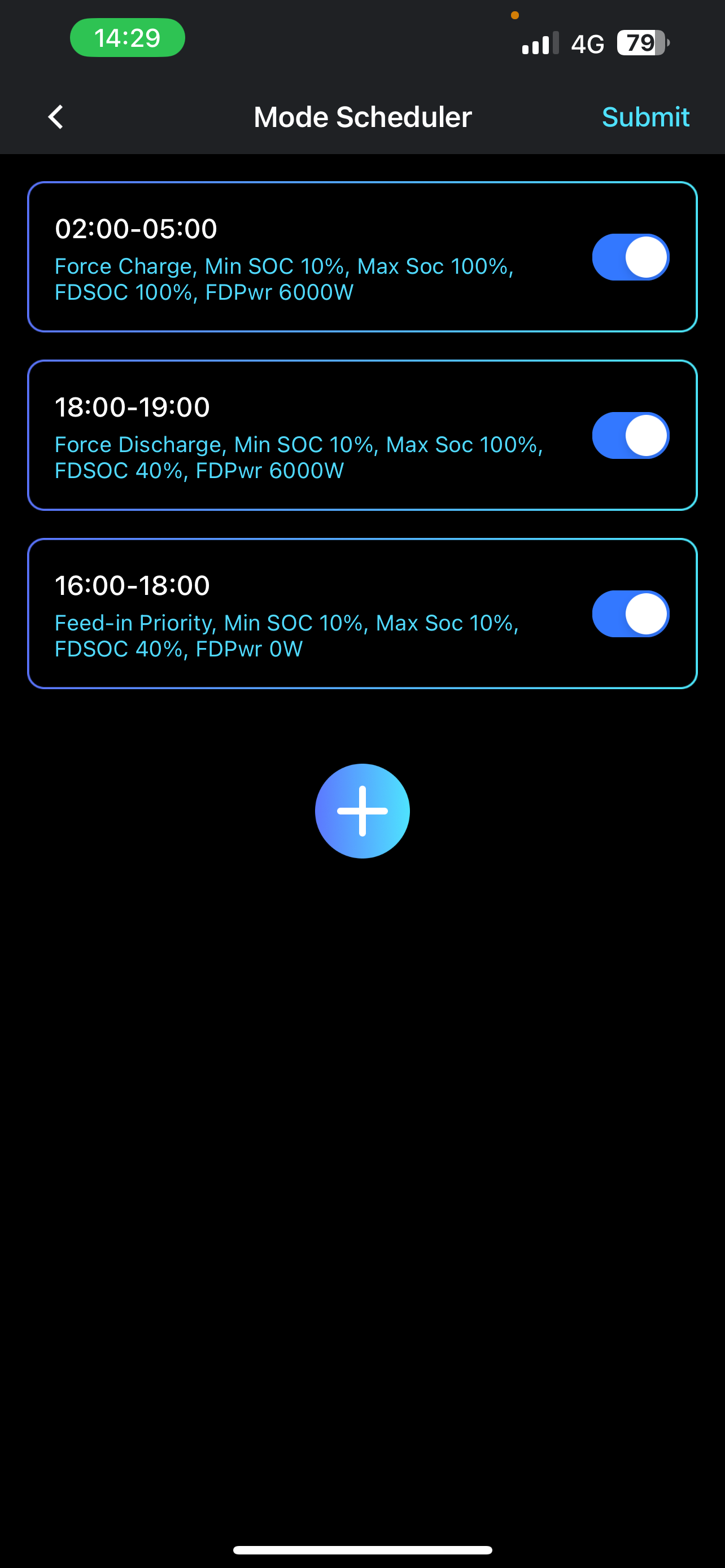

If your battery discharges quickly, you might be better from 4pm to 5:59pm setting 2 items in your schedule, the first one would be to set the inverters work mode to 'Feedin First' - that will export everything you are generating (after the house load is covered) and will only charge the battery if you generate more solar than your agreed export limit (G98) which is unlikely.
Then have the second schedule item as it is now with the start time set to 6pm to 7pm and force discharge your battery.
