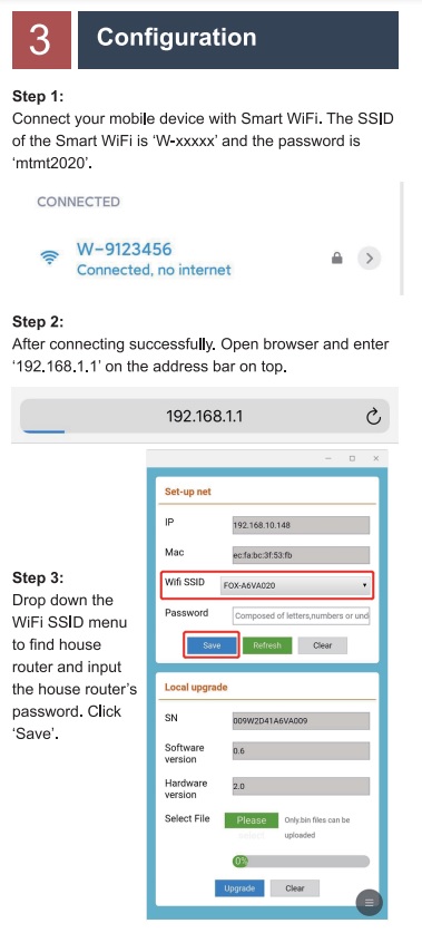

You don't want airplane mode on as that shuts down all your wireless transmissions.
On your phone make sure you delete or forget your normal internet connection, then look in the wifi list for the ssid W-XXXXXXX - connect to this and the password is mtmt2020.
Then follow the attached to connect your datalogger to your wifi.

Still no luck but the inverter in its menu ( with dongle plugged in a flashing RED ) has no IP address. its all Zeros - should it not have an IP ?

Ignore the ip stuff on the inverter screen or app. just set the wifi ssid from the drop down and password. Hit save and then check in the fox app if it starts talking to the fox cloud after 5mins.

No router shows ever in the 192.168.1.1 or app 1 or app 2.
2.4 ghz fixed
5 ghz off etc
