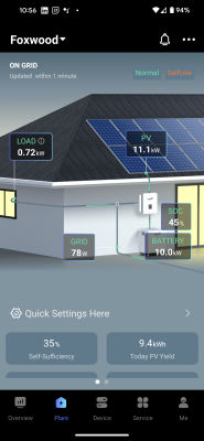

I upgraded my KH10 to the first version that enabled forced discharge. I then upgraded to the following edition which fixed some issues I had with force discharge. At the same time It seemed to reduced my peak production.
I had been seeing over 11kW (11.7 to be exact on the 7th April), even though it should only be capable of 10kW. After the most recent update I am seeing peak production at 10.5.
I'm not complaining as such as I'm still effectively getting more than I paid for, but it's still disappointing none the less.
Would be interested to know if you have any information on the features/fixes that come with today's new version.
Thanks again.
Only 11.1 when I caught it live in the app.

The inverter itself will allow more than 10kW to be generated (DC) but you are limited to a maximum (AC) export of 10kW and the inverter can't generate any more power than it has a consumer for - *but* when your batteries are charging, as they are on the DC side they are not throttled by the inverters AC output limit and so the inverter can manage the extra solar generation - I think is what you were seeing. - your hard limit is the 10kW AC export limit, so it is always best with a large array to leave some space in the batteries to make use all of the generation.
You also tend to find that your solar output on a bright sunny day in April is higher than 'summer' as the panels begin to derate when they get hot - a sunny cold day in April really can be the sweetspot.

Ah I see! That's great to know. Thank you so much :D
