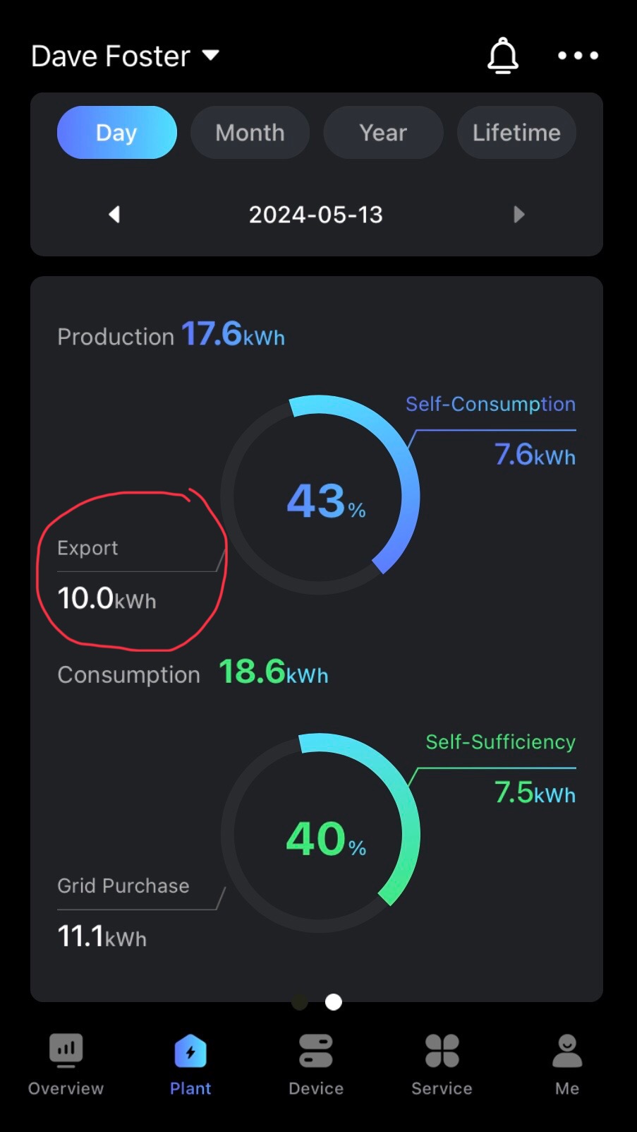

Ok, if it’s the V2 app from the ‘plant’ page (the picture of the house), swipe left and you will see this screen -
You can see the export total for the Day, Month or Year by changing the selection.
