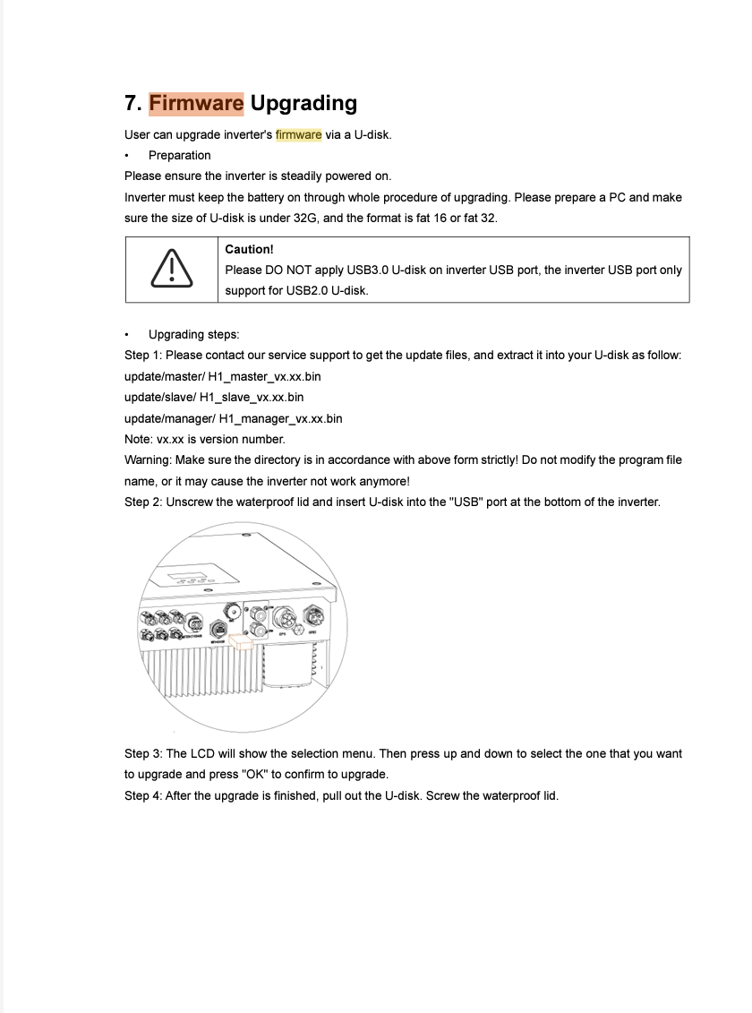

See attachment below of page 32 of the H1 manual. There is a file naming and folder structure to use.
Re: Upgrade battery and BMS firmware?
Thanks, but that only explains it for the inverter itself.
I received firmware update files for the HV2600 BMS (master & slave) and there is an option in the update inverter update menu for this, but it doesn't find the right folder structure for the BMS firmware.
(I updated the Inverter itself without problems previously, following the instructions in the manual)
I'm afraid i've never come across any instructions for battery remote upgrade, probably best to email fox service for advice. I'd be grateful if you can post back what they say so that we'll know for next time. :)
Good point, even the HV2600 manual doesn't state the update process. As per Dave, I would contact Fox and have them do the update over the air for you.
