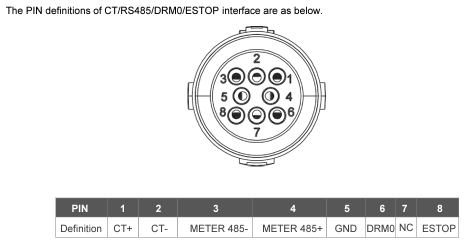

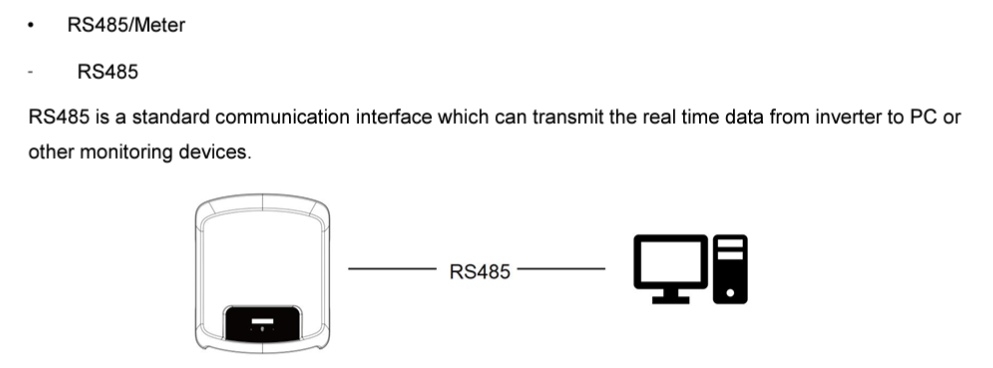

The documentation (page 19) of my inverter mentions connection with a PC over a RS485 connection.

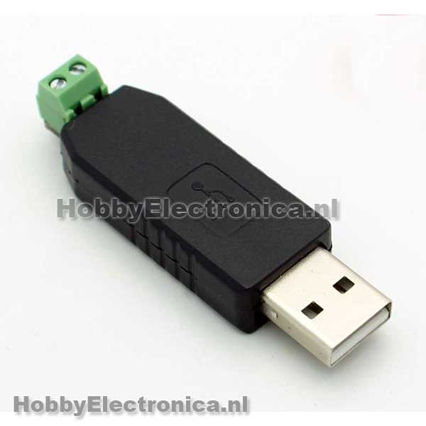

So I bought a USB RS485 adapter and tried to get some readings.
I have not been able to get any data from the inverter to this day. There is no documentation (i'm aware of) that describes the registers (modbus?) that can be read or how to read them.
I'm beginning to doubt it the F4600 model is even capable of rs485 communication. (it has the proper connector for it though)
Does the RS485 communication need to be activated in the menu somehow?
