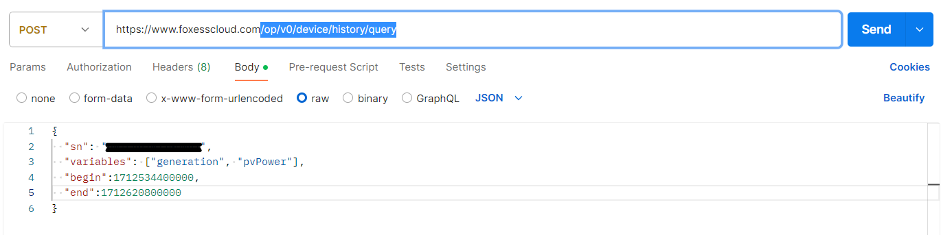

I finally figured it out! It's something realy stupid, as it usually is...
All this time I assumed I posted my requests to "/op/v0/device/history/query" when in fact I was posting to "/op/v0/device/report/query".
My best guess is that I messed up using postman, copying one request to create another and forgetting to adjust the url.
Got it working now. Thanks for the help!
