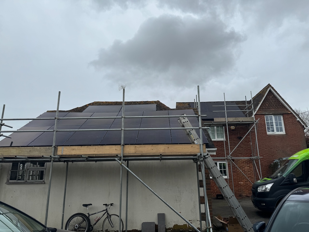

I was originally looking at a 5kW system installed on my garage roof, but I ended up with 8.1kW on the garage roof and part of the main house roof.

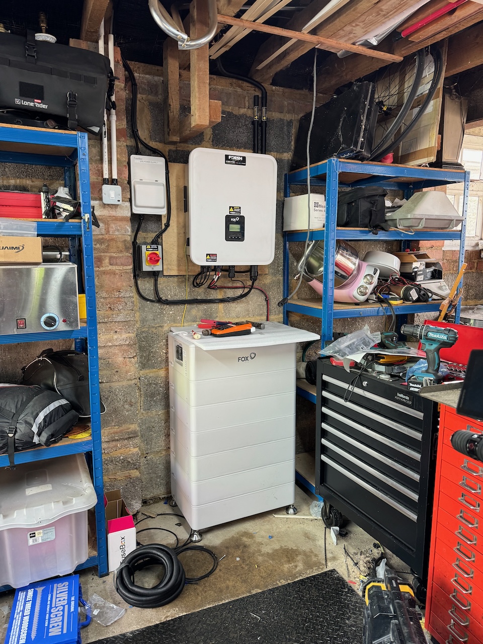

The spec is:
19 * 430W Eurener bi-facial panels, each with Tygo optimisers. Split into three strings feeding a Fox ESS KH7 inverter and a Fox ECS2900 H7 stack of batteries for 20kW capacity. Plus an automated transfer switch to protect us from power cuts which do happen here.
Of course, with a new installation, it's going to be cloudy for the foreseeable future, but everything appears to be working well so far. I have the Fox app on my phone along with Energy Stats, I've got everything configured how I want it so far, have the Octopus API linked up (I am using Agile tariff) and am now waiting for the latest firmware updates to get downloaded so I can try and get automation with Agile working.
I will probably go to a Home Assistant setup at some, but for now, the apps and web portal are doing fine.
Pictures are a bit crap as they are during installation, but then again you've all seen panels and inverters before....

Welcome on board - that’s a very good sized system - the KHx is one of the best inverters Fox make
