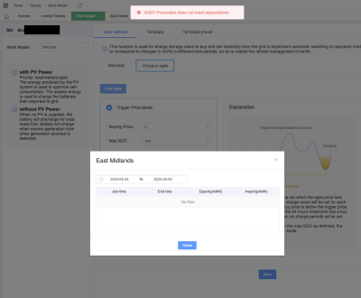

So I recently discovered from a Facebook group that there was a new Octopus Agile Work Model - I have been trying to enable it over the past couple of weeks but it's not working at all? I wondered if I am doing something wrong.
First I tried to set up the Time Slot Mode - but it would not even save that - I profiled the API and the server just keeps thinking it is in Trigger Price Mode, so nevermind I thought and set something up in Trigger Price Mode to charge if the price was below 15p as a test. I left it for a few days and found the battery hasn't charged at all?
Do these settings actually just not work at all? Or is there some other step I don't understand?
The problem is compounded because now I can't seem to set up any force charge periods at all - anyone had a different experience?

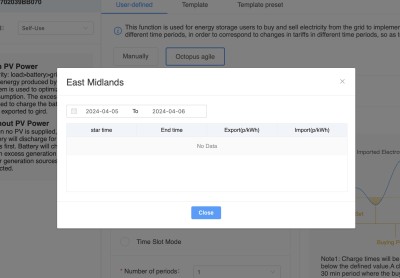

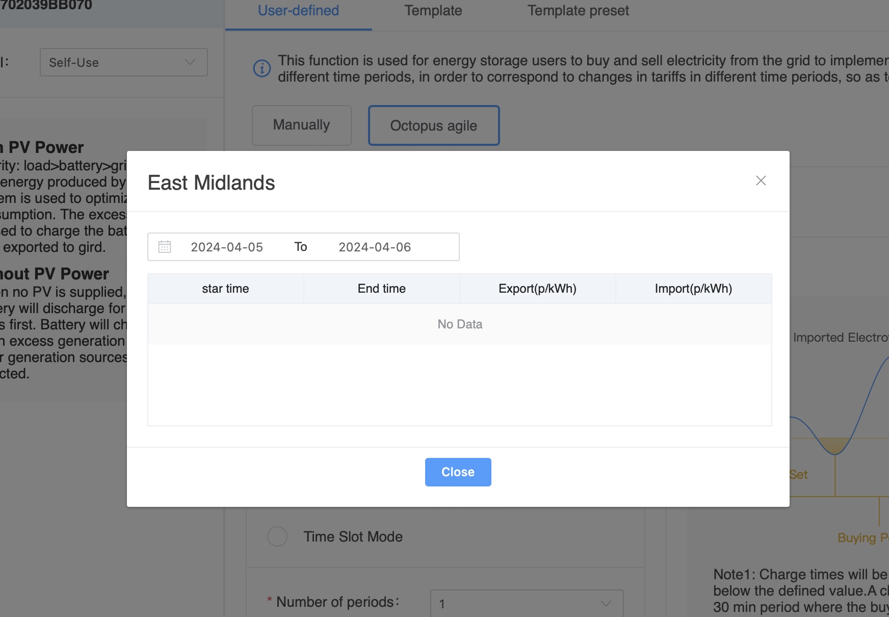

So a bit of a late joiner to this thread, but I am also trying to get the Octopus Agile work model running.
I can see it in the cloud via a web browser, and I can select the different modes and tell it I want to (for instance) buy power at the 4 lowest cost Agile periods.
However - it doesn't seem to be picking up the Agile rates. If I click on the "View Rates" button, it returns a blank table showing my location as East Midlands rather than SE England. No rates populate and I would expect to see a set of half hourly rates.
I also get a "40257-Parameter does not meet expectations" error.
My Octopus API is set up in "My Sites" and pressing the "test" button returns the Agile tariff name, my MAPN and the meter serial number. So I think that's all correct.
Anyway, does anyone have any insight on this? I am currently programming the lowest Agile manually every evening, which is easy enough, but I want to be able to automate it via the integration....

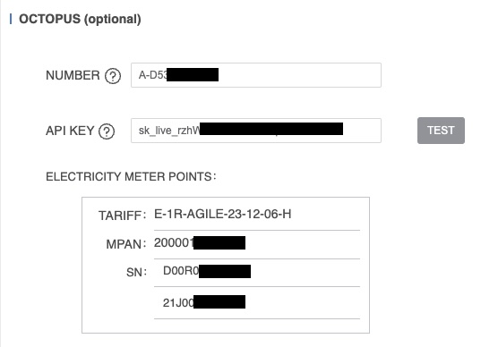

After clicking 'test' you then need to click 'edit' at the bottom of the page. Not intuitive and I suppose it should say 'save'.adm wrote: ↑Fri Apr 05, 2024 12:44 pm So a bit of a late joiner to this thread, but I am also trying to get the Octopus Agile work model running.

OK - I'm now on H1-5.0-E-G2 inverter manager 1.32, which took a full shutdown/reboot to fix issues at inverter level.
As far as Agile goes, 2 issues still remain :
1. Since the change to BST all Agile rates pulled into the Fox ESS cloud table are "out" by one hour
2. Everyone's rate table seems to have the header "East Midlands" hard coded for area, even though the rates (apart from the GMT/BST issue above) seem to be correct...
Fox ESS are aware of both and are working on fixes...

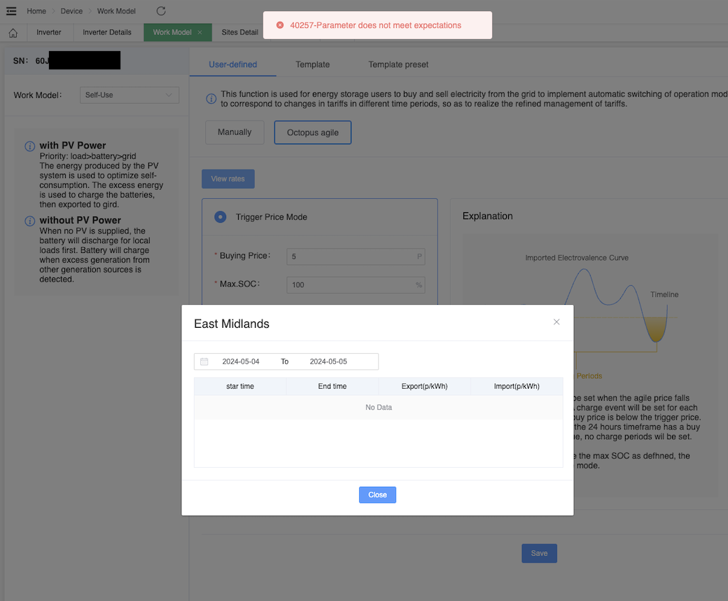

Running H1-6.0-E-G2, Master : 1.22, Slave : 1.02, Manager : 1.34. Put the Octopus customer ID and API key, clicked TEST with positive result of the tariff/MPAN/SN below. Did click the "Edit" button at the bottom after TEST. Also did shutdown whole system after upgrading to 1.22 master and 1.34 manager. Going to Work Model but checking the "View rates" still shows the error "40257-Parameter does not meet expectations". See screenshot below.
Appreciate if anyone had similar issues and found the fix at the end. The only reason I could explain is the Octopus side as I have not received the MCS certificate so Octopus may have to update my tariff to the one that Fox can understand.
