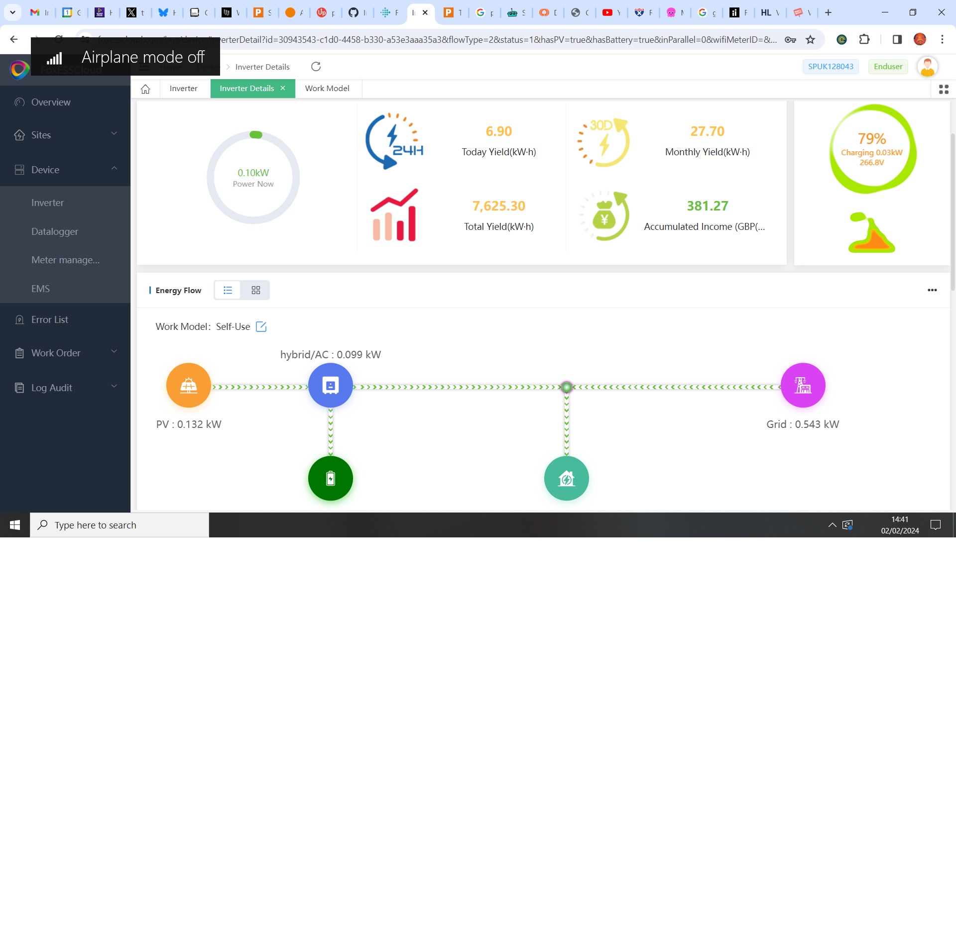

Hi all,
We've had our system installed for over 2yrs and have been very pleased with it. However, for the first time, I've seen a behaviour that I don't understand, and seems wrong.
Today the batteries are pretty much 80% charged, and yet the system is drawing from the grid to meet the load. It's supplementing this with a small amount of power from the panels. System is set to "self use".
We've recently switched to Octopus Flux, so don't really want it drawing from the grid unnecessarily in the expensive period betwee 4 and 7. Is there a way to force it to use the battery?

I should add that I've 'confirmed' the draw by looking at the in house smart meter panel, which shows approimately the same load. So I think the ESS panel is showing something representative of what's really happening.

It's unusual for it to do that, forgive me for going through the more obvious things first that could cause it (I will discount temperature as it is mild at the moment) -
If you have a charge period set (even if the charge from grid is disabled) it will stop the battery from discharging - your charge periods should always be set to 00:00 if not in use.
What are your minsoc settings (they should both be set to 10-20%)
Do you use schedules (Force Charge / Discharge) - if so were any left enabled ?.
Lastly, is your battery firmware up to date - if the batteries are in a state if imbalance it is possible the BMS paused their operation - if you can let me know what batteries and version (i.e. HV2600 V1) I can check latest firmware for you. You can check the battery firmware at the Inverter's panel by clicking on About, Bat Ver (it will show M:xxxxxx and S:xxxxxxx for each slave), also the latest Foxess app shows battery versions if you click View whilst on the battery screen.

I think you've hit the nail on the head! I had a 'charge from grid' set the day before yesterday, to top up before the expensive part of our tariff. I turned it off afterwards, but the times are still in the entry fields. Looking at the inverter details it did the same today, drawing from grid when the battery had charge, so I think you must be right.
Thank you for the heads up, as that's something I wasn't aware of. :oops:
