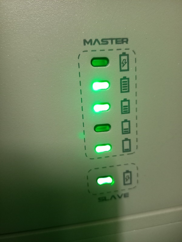

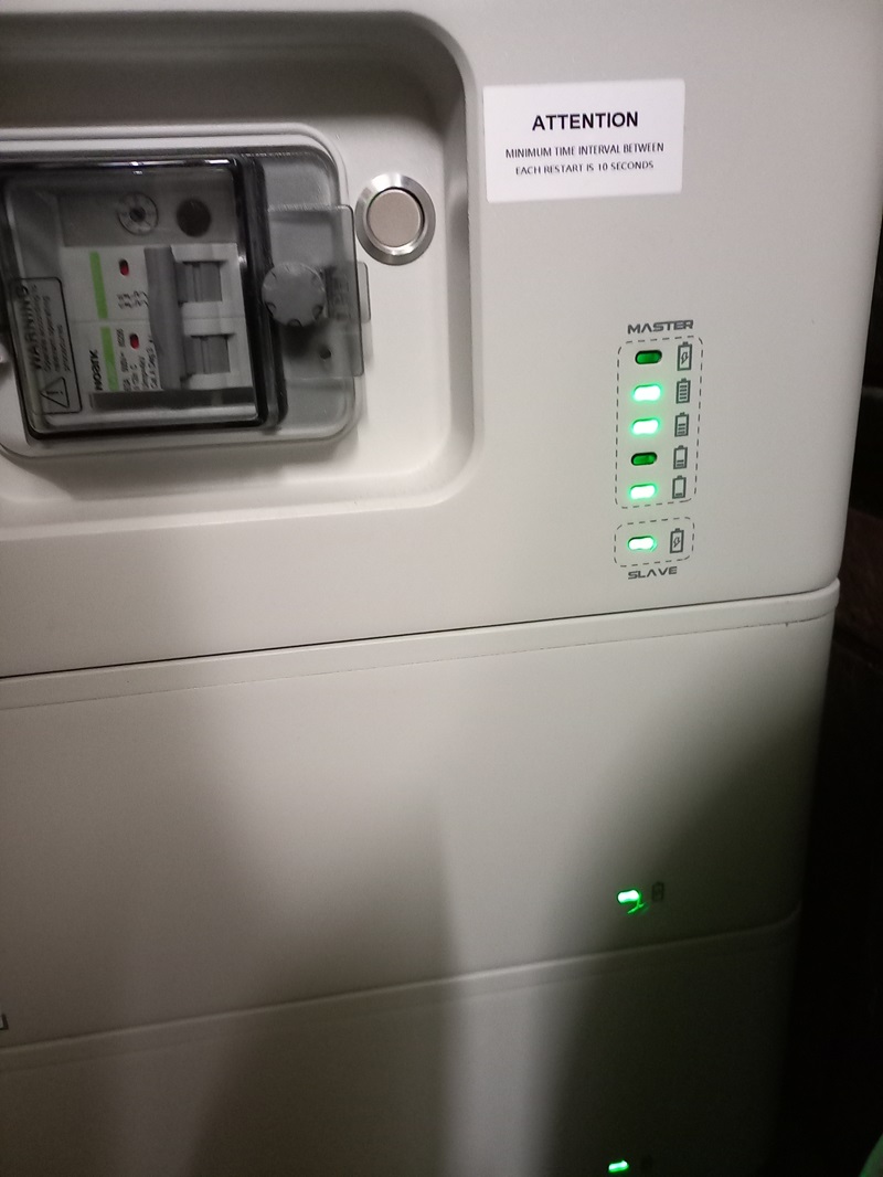

Our FOX ECS2900-H3cube - BMS status LED is "red flashing" plus we have a beeping sound. I added 2 photos, but the flashing red light of the BMS led are not shown on them properly.
Fox APP shows battery status 99%.
I cannot find info in the manuals about how to solve the problem. Do I just push the power button, wait for 10 seconds and then switch it back on again?

Yes power it off (power button), turn off the isolator (DC switch on the battery), give it a minute and then power back on again - if that doesn’t resolve it, it will need your installer or FoxESS support to have a look at the cause of the error.
- Posts: 1790
first the DC switch back on (that basically re-connects the battery), then press the power button (that starts the battery system up)
