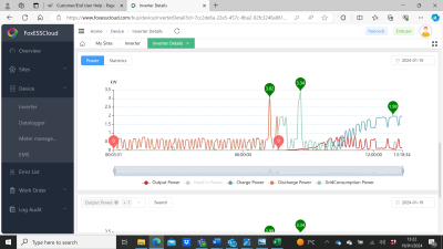

However when it was cold I saw another odd thing (see pic from 19th) with frequent bursts of c. 600w and I can't isolate where this draw was coming from - there is nothing in the property that would need this as far as I can see.

The batteries have a significant amount of thermal mass, given how cold it's been recently, it may take them a little while to warm up - and even 10C isn't *that* warm for these things. They like to be at 20-30C to perform at their best. If they're in a space (garage etc) where they will be at close to external ambient temperature, an insulated enclosure is a really good idea to keep things working right in cold weather.
Re: Still using grid despite charge in battery!
Posted: Mon Jan 22, 2024 12:36 pm
Just to add to what @Calum said, the 600W is likely to be the BMS maintenance charge trying to hold the charge and warm the batteries.
