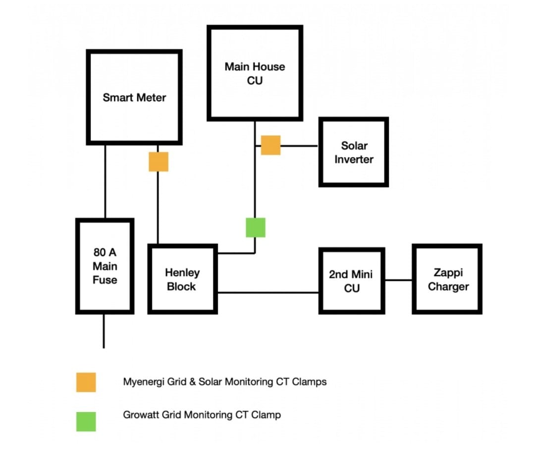

@Jez1987 - From personal experience I would recommend the Zappi EV charger, it is capable of using spare solar charge to charge the EV and for me has proven to be reliable and effective.
Whichever charger you choose the main thing to take into account when working with a Hybrid battery system is that it should be wired into a henley block (splitter) after the smart meter but before the hybrid charger CT clamp connection - that stops it discharging the battery when it starts charging, there are ways and means to get round it using home automation but by far the easiest is to wire it in correctly.
I've attached a schematic (with a growatt inverter) but the principal is exactly the same.

FWIW (anecdotes not the same as data etc) I've also got a Zappi EV charger and have generally been pleased with it, although I'd recommend using ethernet rather than Wifi to connect it to the network, if you can. Wifi hasn't been as reliable as I'd expect, in my experience.
