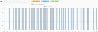

by vip-klaus
The older firmware installed by the service (master 1.69) also causes problems:
During the day, when there is not enough solar power from the roof to charge the battery higher than the minimum SoC, the H3 inverter switches the battery on and off every minute - all day long. This can't be good for durability in the long run and uses up energy unnecessarily. FoxESS is aware of this problem and has been working on a solution for weeks...
