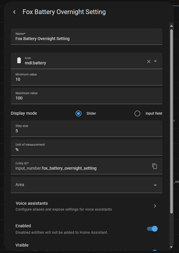

1) Set up an input number and name it "Fox Battery Overnight Setting".
Copy the settings in the image below.
You can modify the step size if you want more precise control over the SoC - I've set 5% as the step size personally.

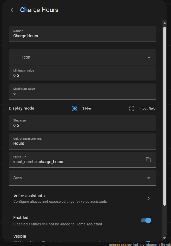

2) Set up an input number and name it "Charge Hours".
You can amend the hours accordingly for the slider - I have it set from 0.5 hours to 6 hours which is more than enough for most off-peak periods.

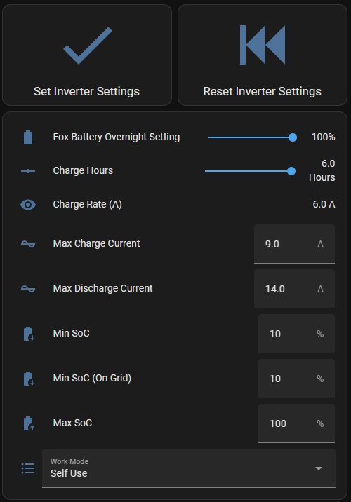

If you want to have the card in the image below on your desktop - create one with the YAML code below.
You can also create buttons that trigger the first two automations and force them to run if needed during the day.
Code: Select all
type: entities
entities:
  - entity: input_number.fox_battery_overnight_setting
  - entity: input_number.charge_hours
  - entity: sensor.charge_rate_a
  - entity: number.max_charge_current
  - entity: number.max_discharge_current
  - entity: number.min_soc
  - entity: number.min_soc_on_grid
  - entity: number.max_soc
  - entity: select.work_mode

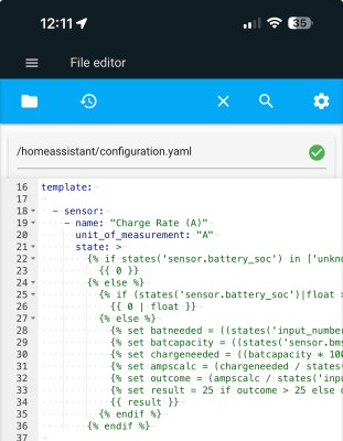

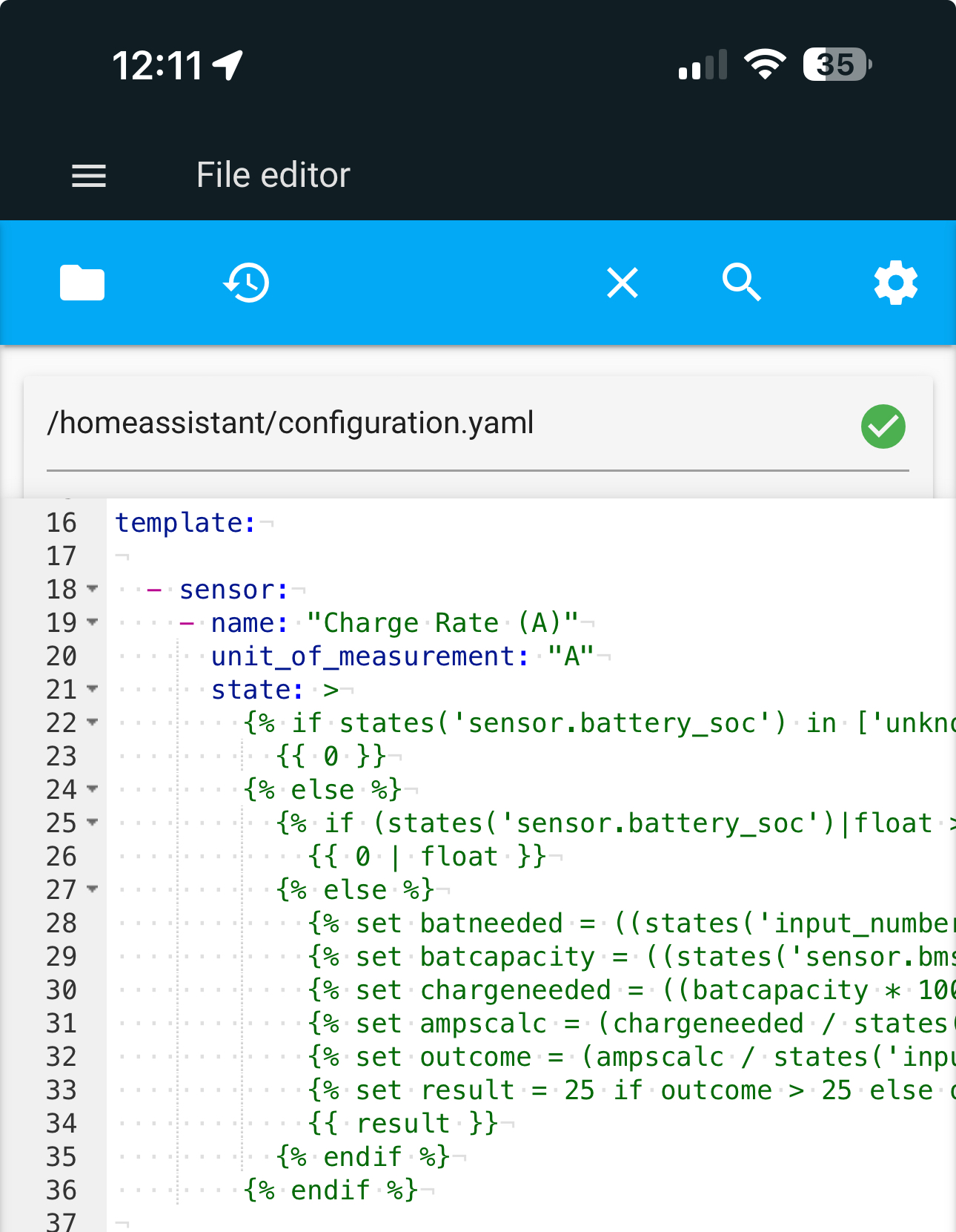

Hi there!
The yaml code needs to be inserted into the configuration.yaml file which you can see and edit by installing file editor within home assistant. You can find this by going to Settings > Add on.
Once you have installed it, you should be able to navigate to find the file above easily :)
Once you’ve inserted then code, save and exit the file and then restart HA.
I’ve added a screenshot below using my phone app to show what it should look like.

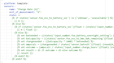

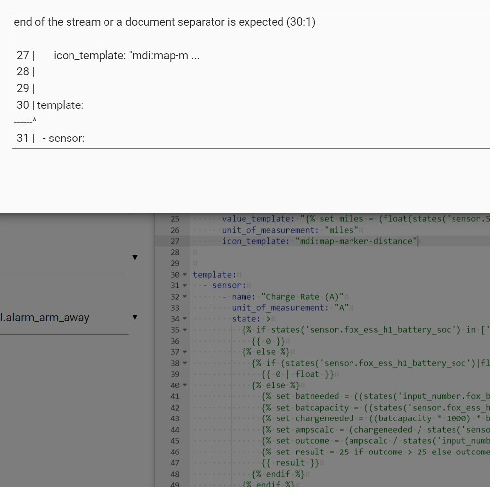

Thanks Ryan. I have a separate sensors.yaml file and get this error when doing a quick reload:
Failed to reload configuration
Cannot quick reload all YAML configurations because the configuration is not valid: Invalid config for [sensor.template]: expected dictionary for dictionary value @ data['sensors']['name']. Got 'Charge Rate (A)' expected dictionary for dictionary value @ data['sensors']['state']. Got "{% if states('sensor.fox_ess_h1_battery_soc') in ['unknown', 'unavailable'] %}\n {{ 0 }}\n{% else %}\n {% if (states('sensor.fox_ess_h1_battery_soc')|float > (states('input_number.fox_battery_overnight_setting')|float * 100)) %}\n {{ 0 | float }}\n {% else %}\n {% set batneeded = ((states('input_number.fox_battery_overnight_setting') | float - states('sensor.fox_ess_h1_battery_soc') | float) / 100) %}\n {% set batcapacity = ((states('sensor.fox_ess_h1_bms_kwh_remaining')|float / ... expected dictionary for dictionary value @ data['sensors']['unit_of_measurement']. Got 'A'. (See ?, line ?).
I have attached what my sensor code looks like.
It looks as if you’ve set up the sensor in the old template format at the beginning.
Try make sure you copy exactly the first 5 lines starting with “template:” and make sure the indentations line up exactly too.

Thanks Ryan. I am getting this error now seems like it's not liking the code above maybe?

It looks absolutely fine, it probably down to the way you've place this sensor within the config file itself. It's very touchy and in my opinion, quite annoying!
It seems to me like you may have inserted lines 30 - 49 inside a "sensor:" grouping.
Try cutting this code out (30-49) and pasting it above wherever it says "sensor:" in your code - this is likely to be in the first couple of lines of this file.

Apologies for the delay in coming back. I tried what you mentioned by placing the lines 30-49 at the top (above the existing sensor) but I think it's still complaining about the separator and might be due to the old type of sensors, mixed in with the new ones.
