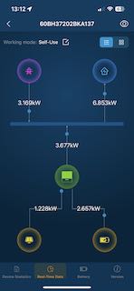

Can you post a screen shot of the real time data screen from your app - you should see power flowing towards the house from either the PV or batteries (not the other way round)

It’s a new install, I’ve had issues with the realtime data showing the power flow going from my house but sometimes it’s ok. At the moment we aren’t using almost 7kw. I did try previously to switch the ct clamp around and that made the realtime data look even worse.

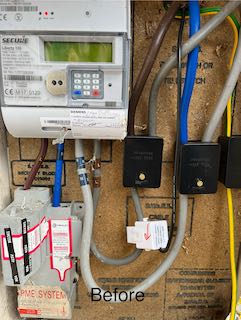

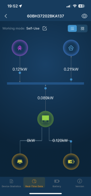

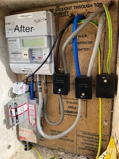

Just checked the CT clamp and I think its incorrect. See pictures of before and after for where I think it should be. Please correct me if I'm wrong! The real time data looks good now.

Ok, yes looking at the data screens the CT clamp was definitely the wrong way round before.
The CT clamp position was ok but I suspect the polarity of the cable has been crossed by the installer - normally the arrow should point towards the grid (which it did), but in the new position the arrow is pointing towards the house which tells me the cable has been reversed - it would have worked where it was with the arrow pointing towards the house - but it doesn't make a huge difference being on the input or output of the meter.
Just a quick note the real-time data screen is a snap shot taken every 5 minutes so not very 'real' time, you have to give it some time to take a number of readings before you can rely on it.
Hopefully this will work ok, the only observation I would make is the live feed from the meter goes into the black Henley block where it splits, that is normally what happens when you have an EV charger fitted (or a split consumer meter).
If you do have an EV charger fitted, where the CT clamp is fitted now the inverter will see the EV charger as house load and try and supply it from the batteries which will flatten them real quick - if you do have an EV charger, find out which one of those live feeds that comes out of the block is going to the house and which is going to the charger - put the CT clamp on the one going to the house and point the arrow towards the house.
