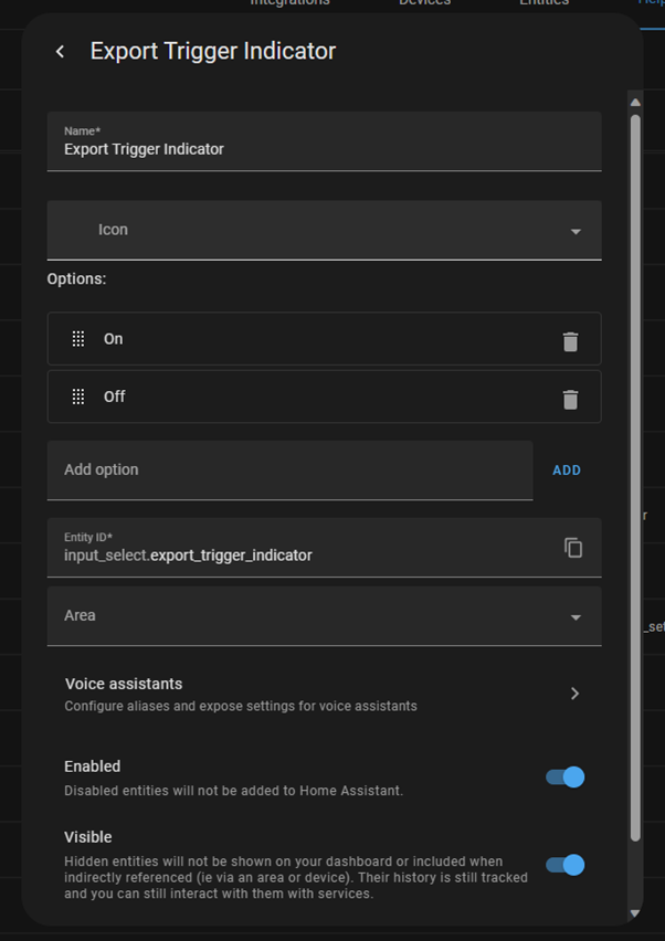

3) Create a helper - this will be a simple drop down list named "Export Trigger Indicator" that shows either "Yes" or "No" (see image below) - this will be used to track whether the export sequence has been activated or not.
