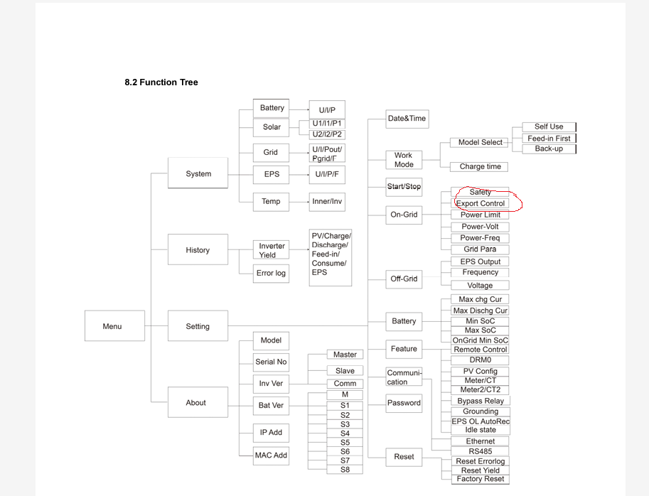

You can do that by reducing your Export Limit in the inverter settings (Export Control) - you can set it to whatever you want in watts, so if you never want to export power then change it to zero.
As I said on the other post, the inverter will then derate it's MPPT to reduce it's output power as it must have a consumer for every watt of power that it generates.
It won't burn out your inverter exporting power to the grid, that's what it is designed for - in summer it might get hot in which case it would derate anyway.
If you have an agent account you can set this on the Fox cloud, if not you will have to do it at the inverter panel (Settings, Password (usually 0,0,0,0 enter), On Grid, Export Control - set a value in watts).
