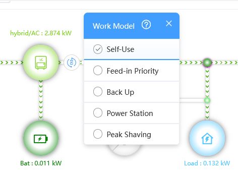

Hi there, for about the last week there has been a bug in the web based app which is annoying and I hope someone can point me in the right direction to get it fixed.
It is the switch offered to allow the work mode to be changed remotely from "Self Use" to "Feed-in". It used to be at about 4 o'clock by the invertor icon but is now at 3 o'clock and displays differently, so:
The problem is that when you try to switch mode, a password request pops up, but even with the correct password, it gives an error of:

I have checked with the android based version and see there has also been a change but it still enables mode changes. On the other hand, the web based version accessible in a browser (I am using Firefox) definitely does not lett you change mode.
