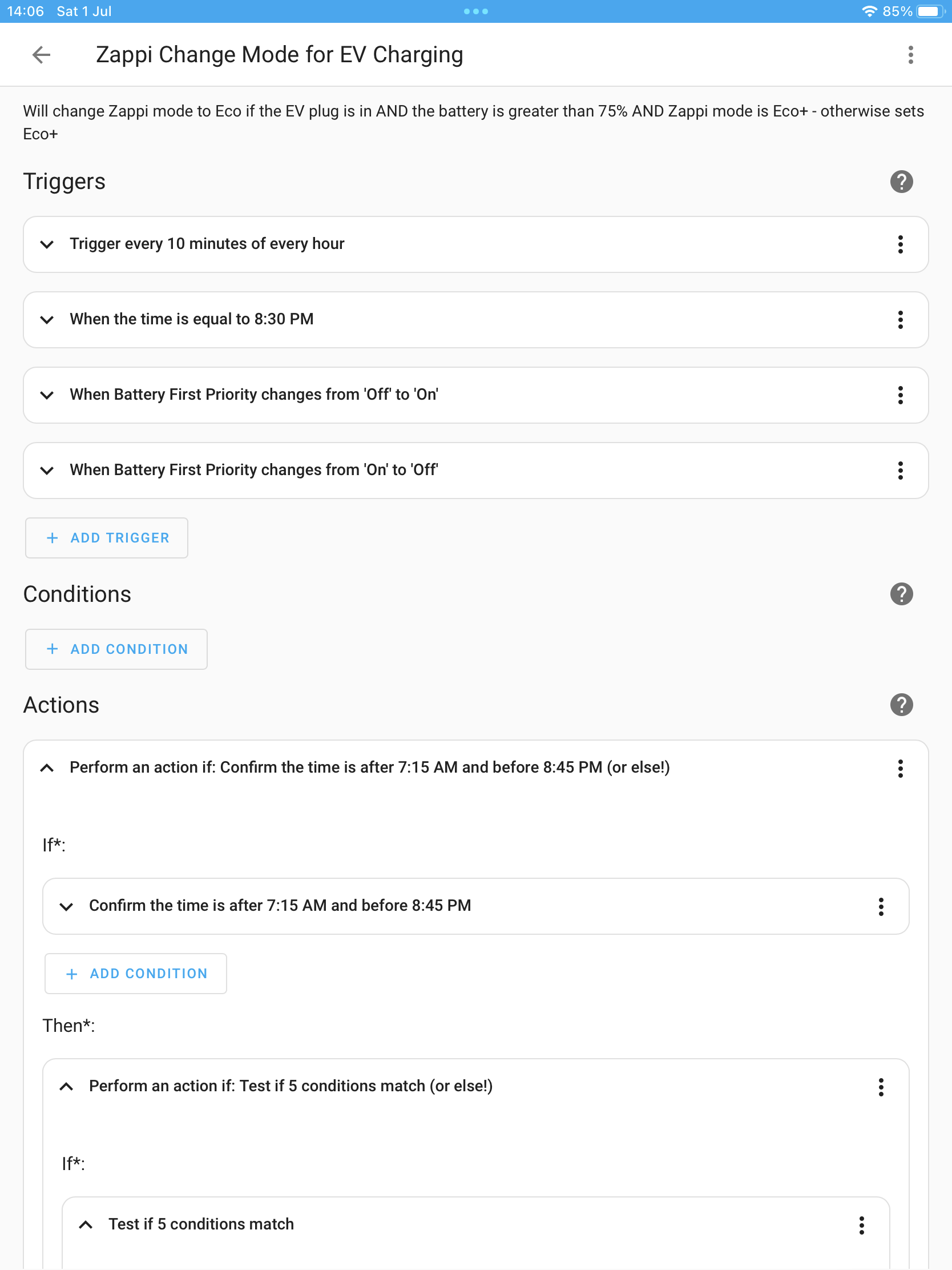

This automation manages the Zappi charger and switches it on and off depending on a number of conditions, such as home battery charge, solar generation and time of day.

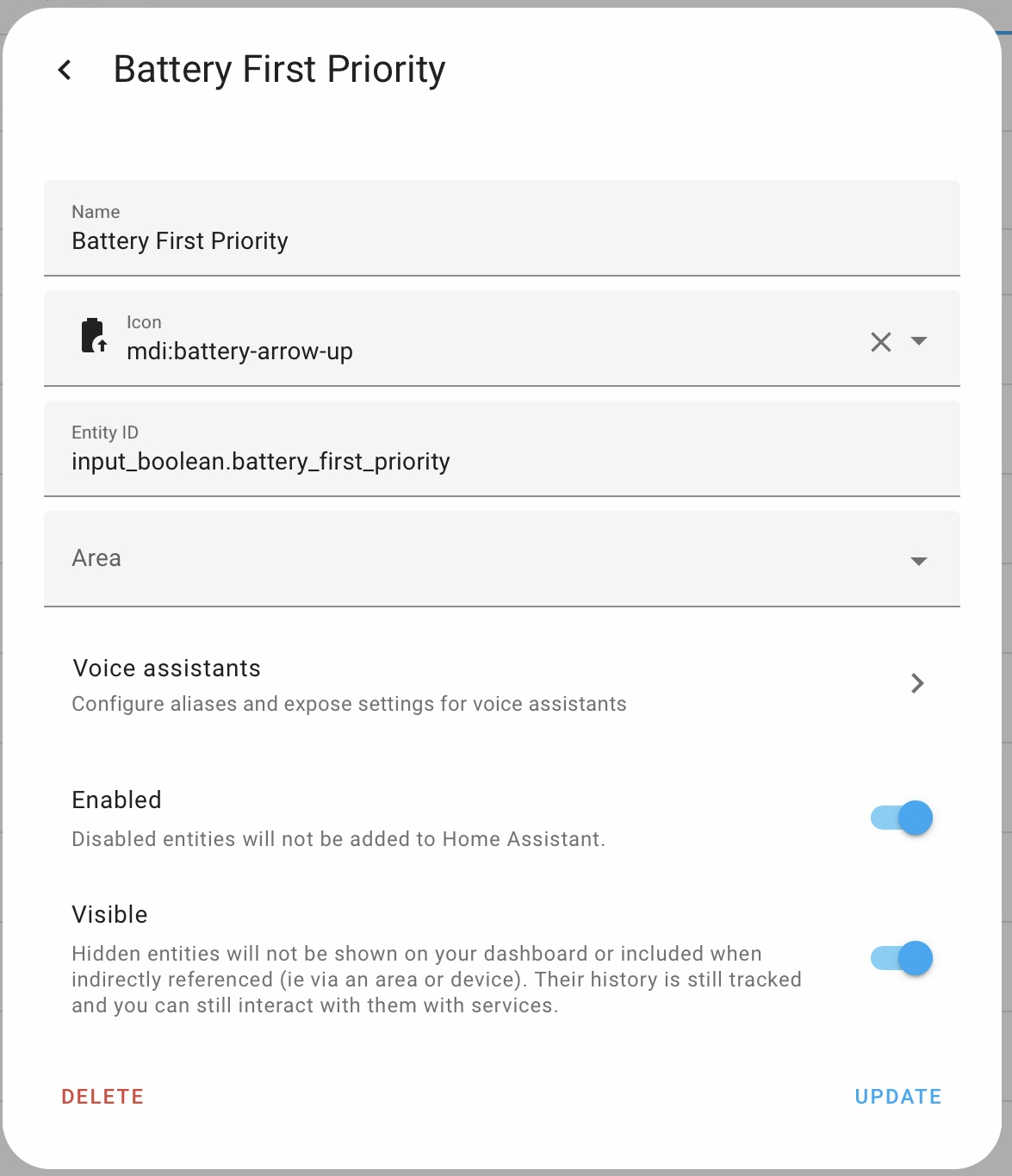

Firstly set up a helper toggle which is used to change the priority given to the home battery, it the toggle switch is on the home battery will be allowed to charge from solar and the Zappi will be kept stopped, if the switch is turned off the Zappi will get priority but there has to be enough solar generation to cover the minimum use (1.4kw) and the home battery must be above a certain SoC.
The automation is active between 7.15 and 20.45
This is the setting for the helper toggle

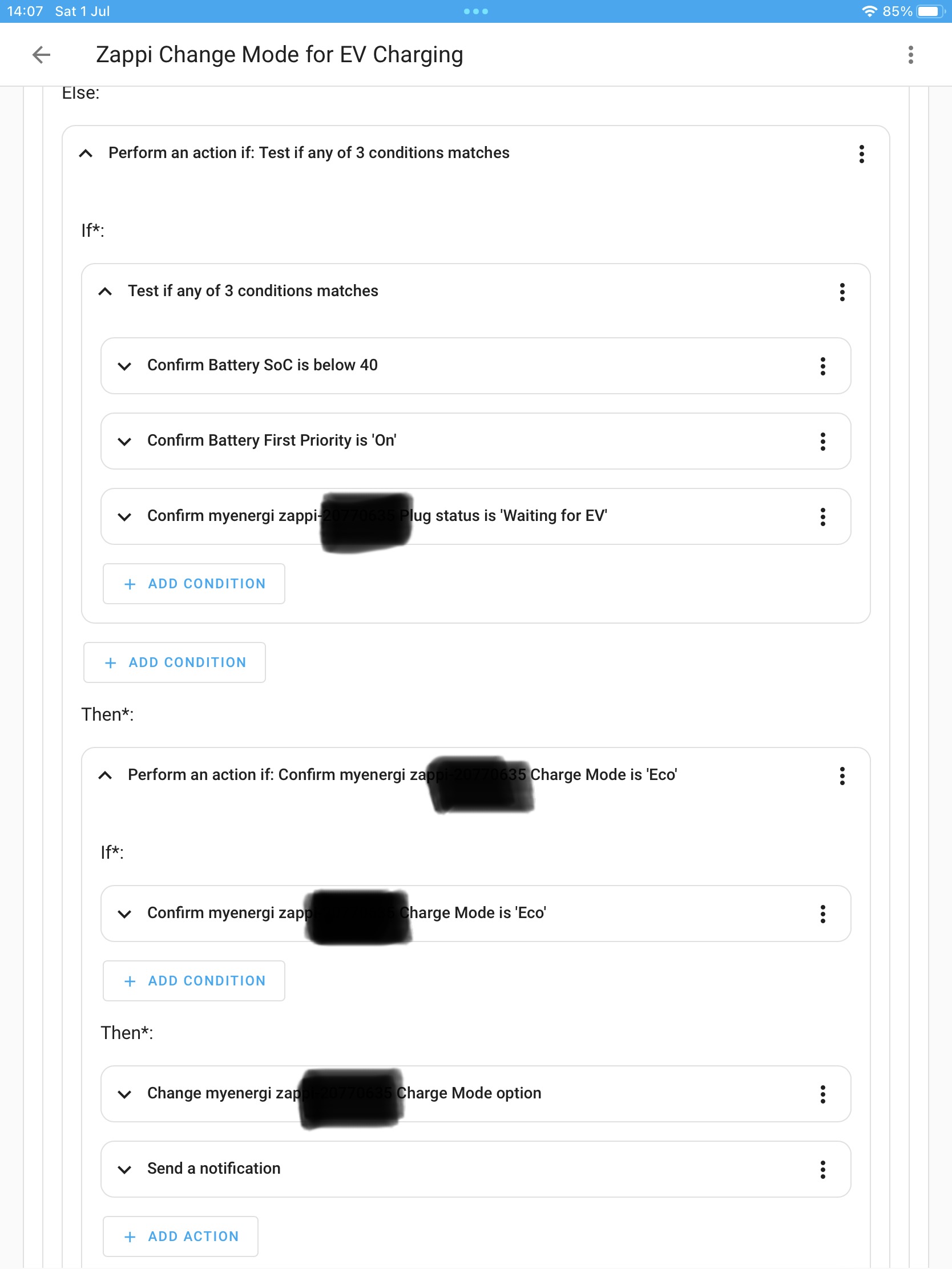

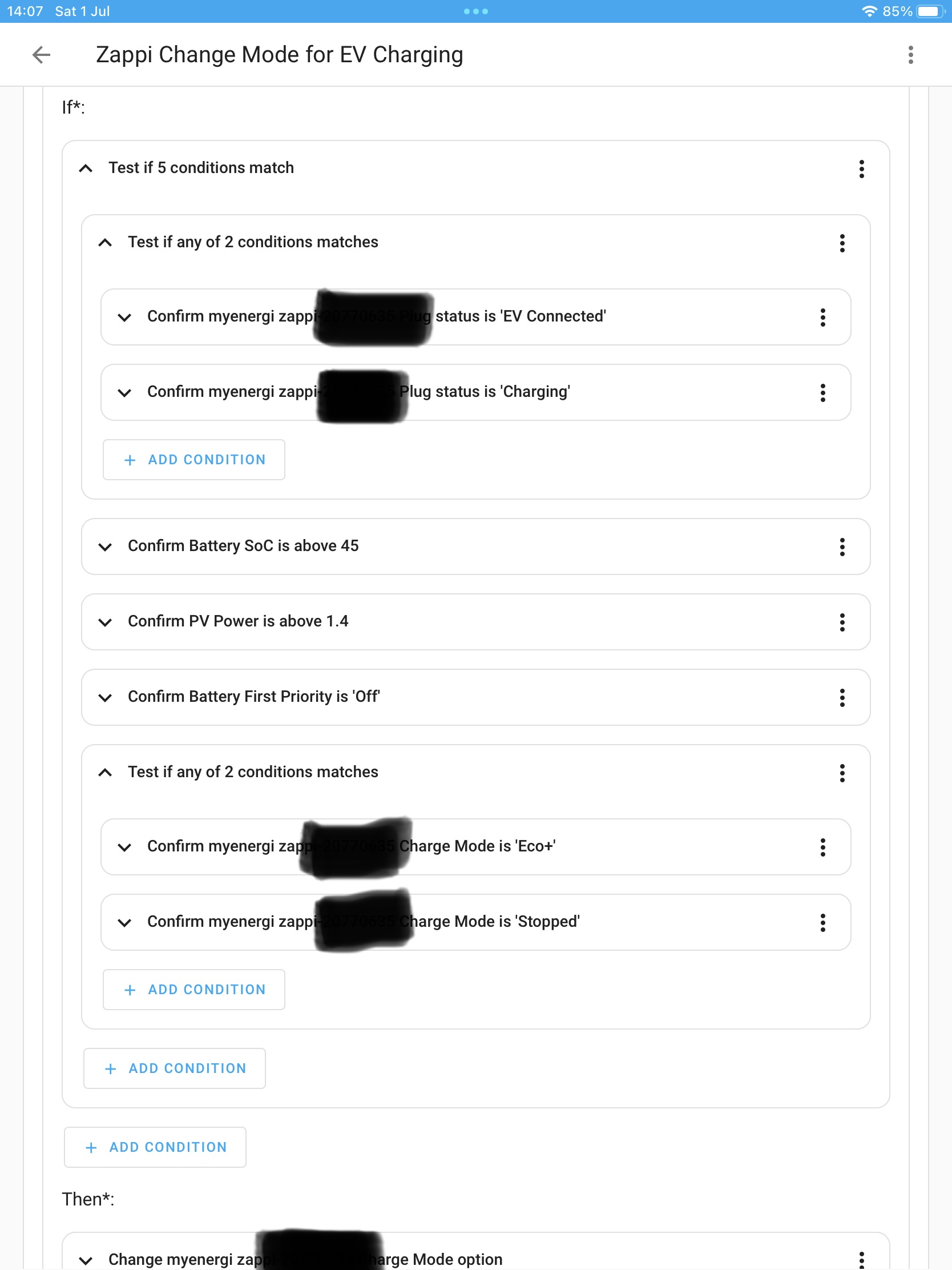

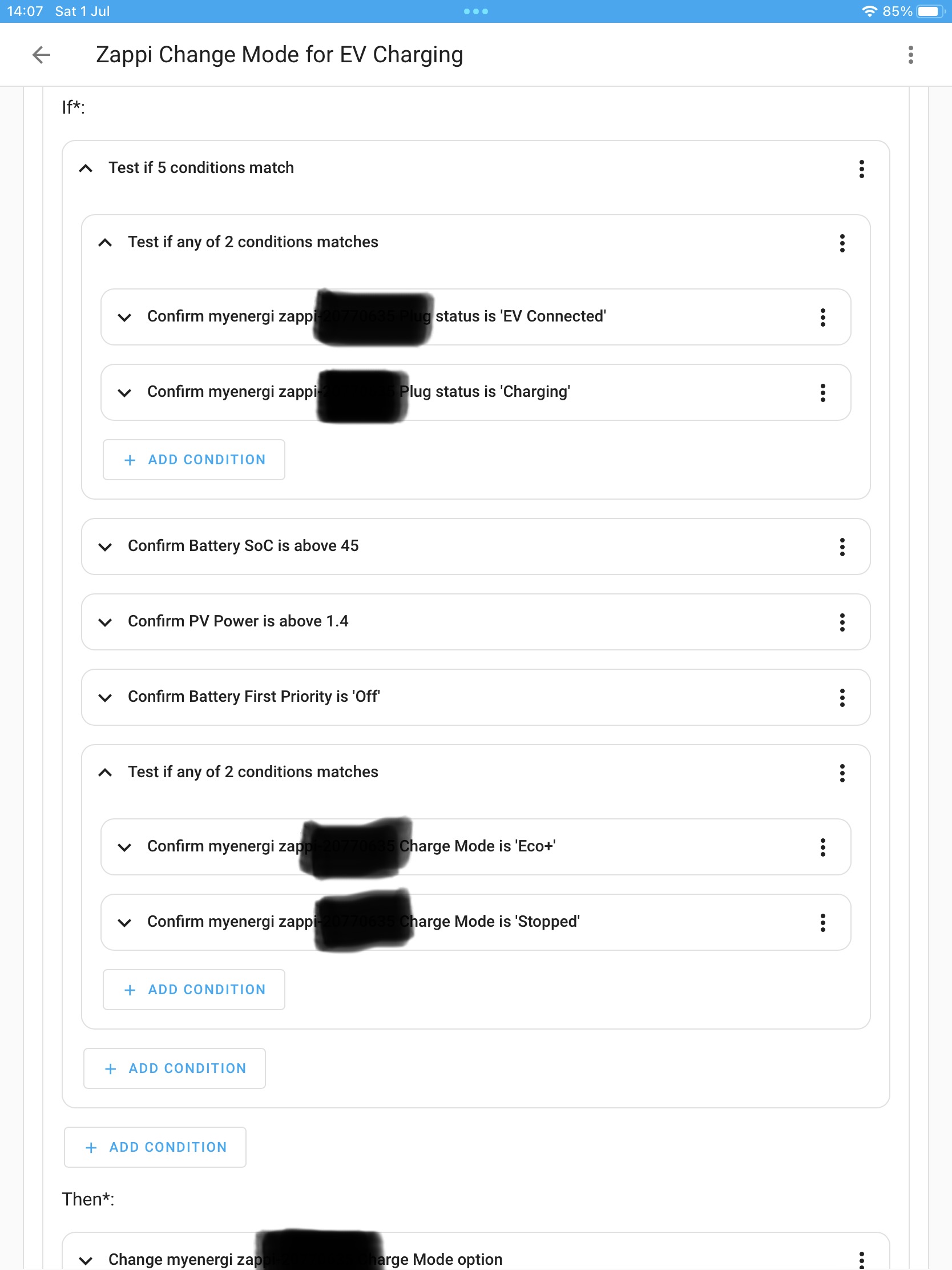

This is the visual editor for the automation -

      - if:
          - condition: and
            conditions:
              - condition: or
                conditions:
                  - condition: state
                    entity_id: sensor.myenergi_zappi_87654321_plug_status
                    state: EV Connected
                  - condition: state
                    state: Charging
              - condition: numeric_state
                entity_id: sensor.battery_soc
                above: 45
                enabled: true
                entity_id: sensor.pv_power
                above: 1.4
              - condition: state
                entity_id: input_boolean.battery_first_priority
                state: "off"
              - condition: or
                conditions:
                  - condition: state
                    entity_id: select.myenergi_zappi_87654321_charge_mode
                    state: Eco+
                  - condition: state
                    state: Stopped

        else:
          - if:
              - condition: or
                conditions:
                    below: 40
                  - condition: state
                    state: "on"
                  - condition: state
                    state: Waiting for EV
            then:
              - if:
                  - condition: state
                    state: Eco
                then:
                  - device_id: 15300798a849373356a7b18cacec767e
                    domain: select
                    type: select_option
                    option: Stopped
                  - device_id: d514ca0fc5e61f231178ed4d3b9fece8
                    domain: mobile_app
                    type: notify
                    message: Zappi mode Stop(Charge)
                    data:
                      push:
                        sound: none
                    enabled: true
    else:
      - if:
          - condition: state
            state: Eco
        then:
            domain: select
            type: select_option
            option: Stopped
            domain: mobile_app
            type: notify
            message: Zappi mode Stopped (Time)
            data:
              push:
                sound: none
            enabled: true
