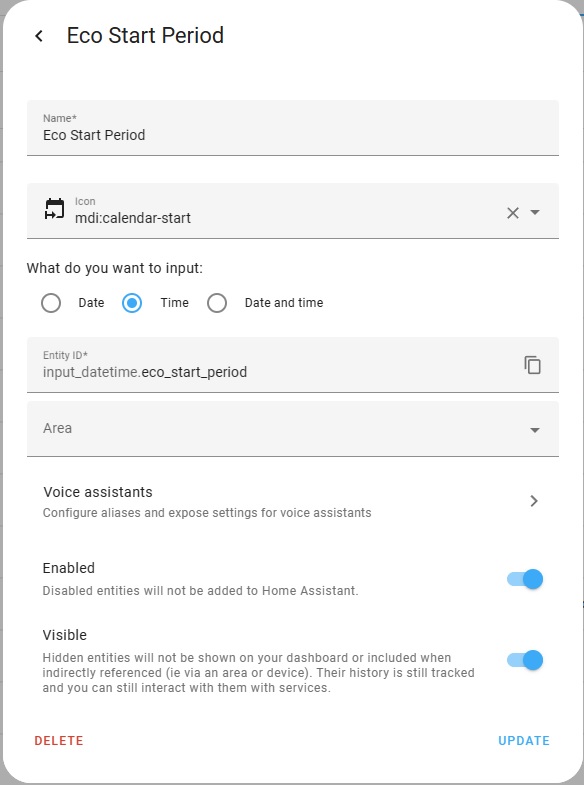

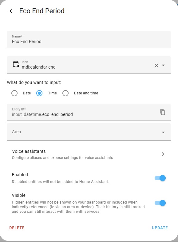

There are 2 datetime helpers creating for Eco Start Period and Eco End Period.
The helpers are created under Settings, Devices & Services, Helpers (at the top), click on + Create Helpers, then choose 'Date and/or Time' and set them as follows -
Once created, click on the Helpers and set them to your Eco tariff i.e. for Economy 7 it would be 1:30am for start and 08:30am for the end.

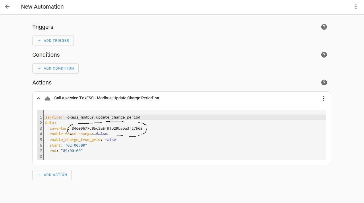

As the Zappi sensor name is unique to your installation you will need to update the 'conditions:' line that contains the Zappi sensor in it and replace it with your sensor.myenergi name, it looks like this 'sensor.myenergi_xxxxxxx_power_charging'
As the Inverter 'device' is also unique to your installation you will need to update the device name in the code with your inverter device - you can find your inverter device_ID by creating a new blank automation, click '+Add Action', and choose 'Call Service', in the 'Service' box start to type 'Foxess - modbus' and choose the item in the list 'FoxESS - Modbus: Update Charge Period'
In the box below for 'Inverter' click in the 'Device' box and choose your inverter (there will usually only be one unless you have multiple inverters), now click on the three dots in the right corner of this action and select 'Edit in Yaml'.
You will see your inverter device ID (see the image below), this is your unique inverter device ID and must be copy and pasted into the automation code above in the 2 places that you see 'inverter: xxxxxxxxxxxxxxxxxxxxxxxxxx'
You can exit this screen by clicking the <- Arrow in the top left corner of the New Automation screen and choose 'Leave' to exit without saving.

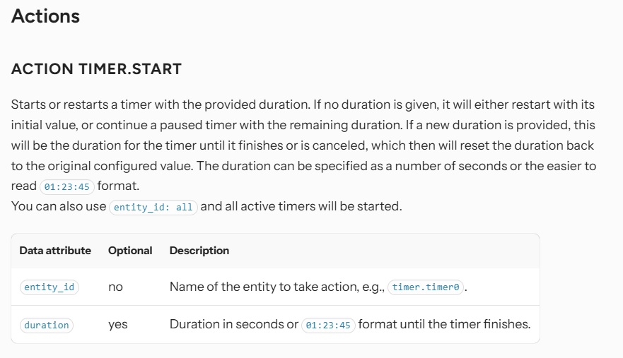

I'll be honest i've never used the time start action, but just looking through the notes, it shows it as taking either a duration in seconds or a timedate helper.
I've tried to create a timer and then add the hours: key and it gets very confused..
Which suggests the action code should look like this -
Code: Select all
action: timer.start
metadata: {}
data:
  duration: "{{ states('number.fd_automationtimerduration')*3600 }}"
Wondering if that would work ?
