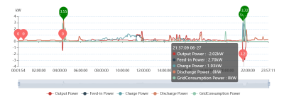

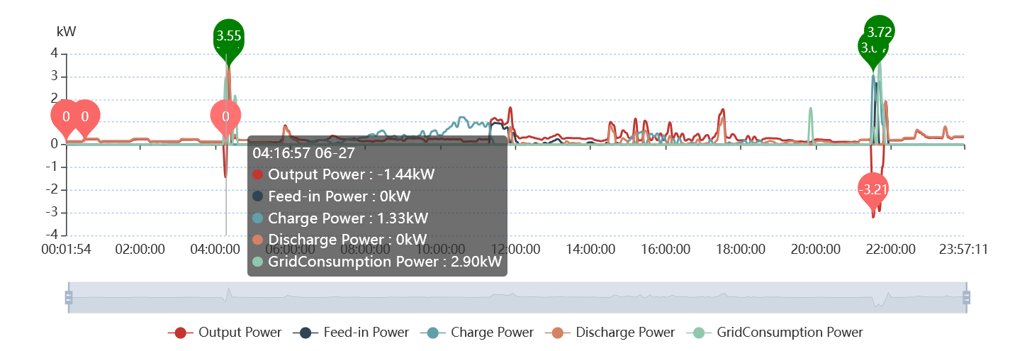

This is my first post here and I'm hoping someone might know what this is. I had my system installed at the end of April. All seems to be working fine, but I've noticed that just after sunset each evening that there are some quite loud clicking, humming and arcing sounds coming from the top right rear corner of my inverter. Looking on the Fox ESS Cloud website there are some crazy spikes where I'm importing, exporting and charging the battery during these times. I can also see similar patterns just before sunrise in the graphs too, but that's too early right now for me to check if the same thing is happening. Here are a couple of screenshots:

I've mentioned this issue to my installer already but they haven't got back to me yet with any indication of whether this is normal or not. This issue seems to be causing most of my daily grid imports, so it would be great to get it sorted if this isn't meant to happen.
