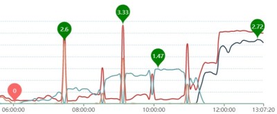

On and before 25-May, we had the expected output trace – a nicely curved "blob" slowly increasing from 8AM to a 1230 peak @4.8KW approx., then slowly decreasing until 5 or 6PM.
But since 26-May I have had a strange "stepped" output trace and much reduced power generation. On a perfect sunny day, output gets to 1.7/1.8KW by 0930ish and stays flat for a couple of hours, then shortly before midday it suddenly shoots up to 3.2KW where it again stay flat until it starts decreasing as the sun goes down. Please see attached screenshot of yesterday's trace. And as I type this, exactly the same thing has just happened at 11:40 - one minute we were generating 1.8KW, the next 3.2KW with no change in conditions. But it'll stay here now an hour or two before starting to decrease, it definitely won't hit the 4.8KW high at 1230ish we were enjoying a month ago.

My installer emailed Fox Technical Support and they pointed at the ambient temp / inverter temps going too high in the hot weather. But this started happening late May. The last three days I've been running a fan over the inverter and it is reporting ambient and inverter temps lower than they were in May when we were getting no steps and 4.8KW peak.
I believe my inverter is faulty and broke on or around 26-May when these strange output traces started happening and max power generation reduced by approx. one third. I am sooooo frustrated that despite the ongoing stunningly perfect conditions, on days we use the oven we run out of battery power in the middle of the night and start importing from the grid, despite our £10K investment
