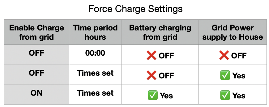

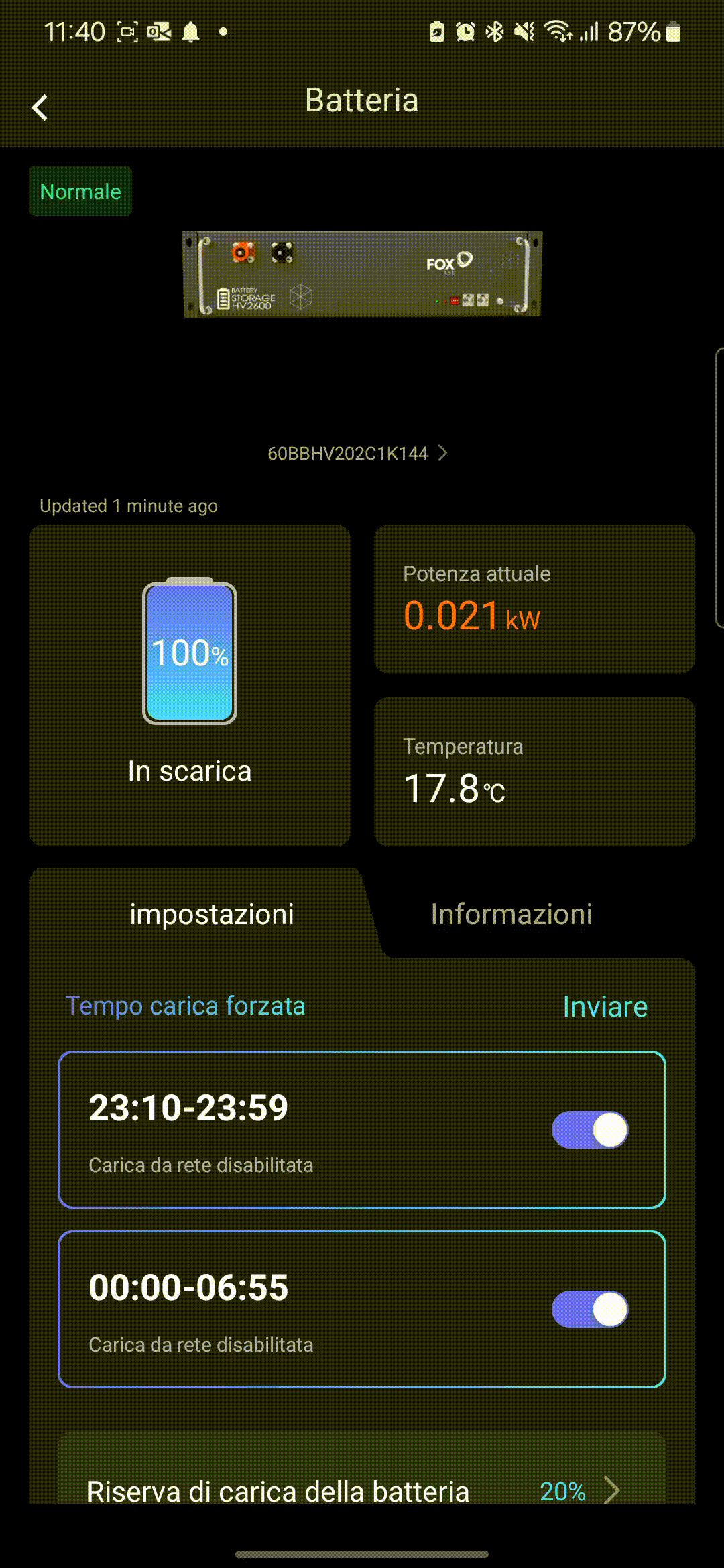

I noticed last week the option to select a force charge (as in not use the battery) disappeared from the WebGUI, and now I note it has gone from the mobile app too. Anyone else seeing, or know why? I would use this if I thought I didnt quite have enough to get through the night, so I'd use grid between say 00:30 and 04:30 but didnt want a battery charge, or, if I am needing to charge the car over night to prevent taking from battery. All I can do now is force charge from grid and annoyingly, as I had set it to 'force charge' it is now stuck and I can't see anyway to now change this! Why would they remove this?
Any pointers? (other than complain to the rather unresponsive service team)
Lost option for Force Charge
See
https://www.facebook.com/groups/foxessownersgroup/permalink/1862360824146091/
- Both times set to midnight: Charge period disabled
- Times set but "Enable charge from grid" disabled: battery won't discharge but won't charge from grid. The same as checking "Enable force charge" previously
- Times set and "Enable charge from grid" enabled: battery will charge from grid. Same as checking both "Enable force charge" and "Enable charge from grid" preciously

Seeing the same issue, I have raised a support ticket, but I'm not holding my breath. My inverter still seems to be working as before i.e. charges car from grid overnight on cheap Octopus tariff, but does not top up battery, so we can store the solar.
It's not an issue as such, in that you can still set it to charge (or NOT discharge), they've just changed the interface for that in an odd way.
From a user experience POV I think it's terrible design, but you can still do what you could before.
I didn't think this issue of not discharging mattered to me at the time, but thinking about it, maybe it does.
So, I see that if I set either of the "Enable charge from grid" toggles for some set period, the battery will charge from the grid and not discharge in that period. But is it possible to set it to neither charge nor discharge for some period, i.e. retain whatever charge is has at say 00:30 hrs and supply the load only from the grid until say 05:30 hrs? I'd then want to charge from the grid from 05:30 to 07:30 or the preset max SoC, whichever comes first.

Set a time, do not enable the toggle, as described above. Then it won't charge from the grid, and won't discharge.
