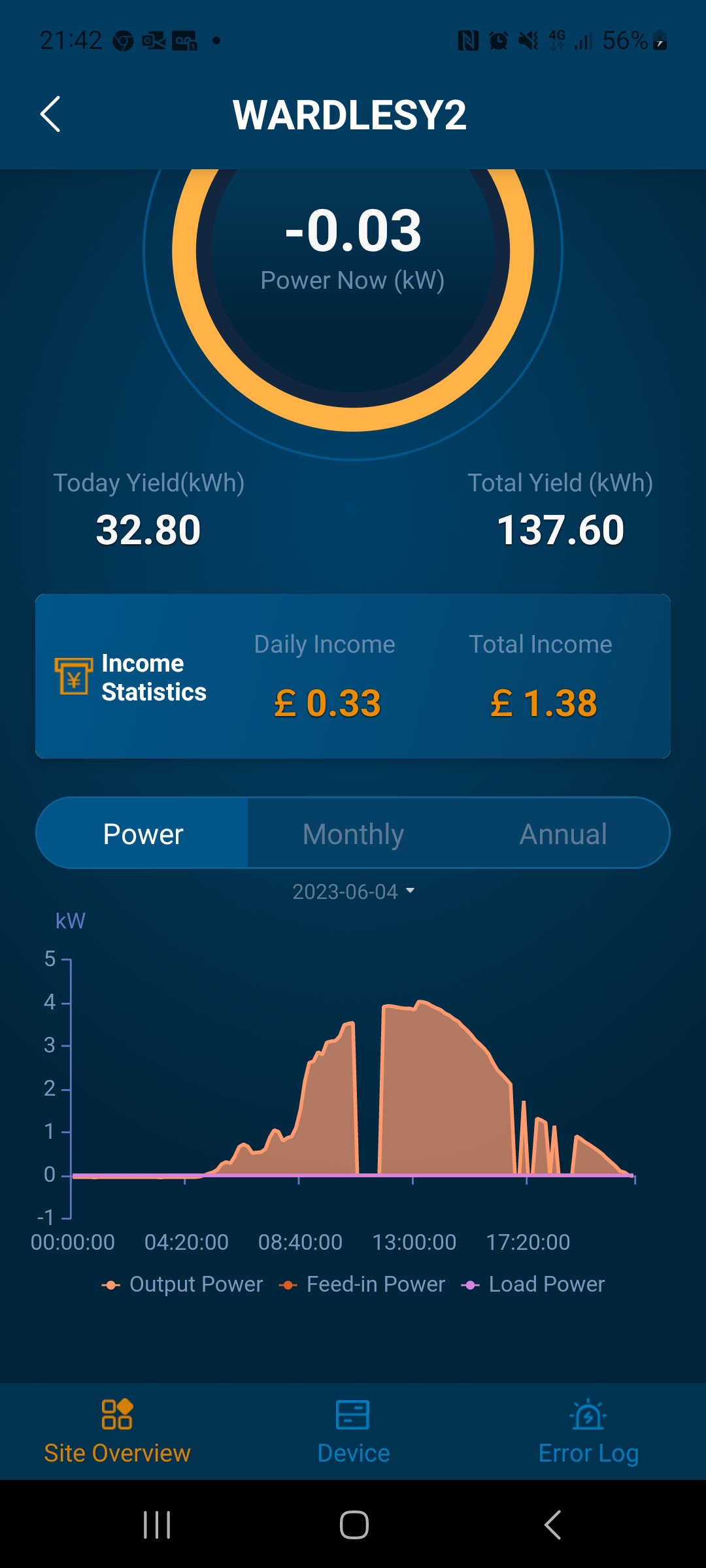

Multiple problems (feed to grid and battery use)
- Posts: 1
- Joined: Sun Jun 04, 2023 9:34 pm
1re grid charging: you can configure if battery should charge from grid and when via mobile app (you might want to charge battery at cheaper rate when its going to be cloudy tomorrow).
2 re battery charging: lithium batteries don't like to be charged to 100% or discharged (they degrade more quickly) on inverter menu you can check if there has been upper limit configured your you battery (lower limit setting is available via mobile app).
3 re. export to the grid: apparently there is a setting in inverter's menu to configure on-grid/off-grid (posted a question in different thread and someone just responded to it).
