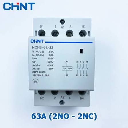

You can run all your back up on auto contactors. You need to spread the load out over the 3 phases as you only have 5kW/phase with a 15kW inverter.
You could do your system with a 4pole 2NO 2NC (below) and a 2pole 1NO 1NC contactors. To cover all 3 phases.
You can run 4 circuits on a 4 pole and 2 on a 2 pole.
On a 4 pole R2 & 2 (combined) go to 2 circuits as do R4 & 4 (combined).
R1 & R3 go to 2 separate EPS ports and 1 & 3 go to the grid.
A1 to Grid L and A2 to Grid N.
Normally power runs from grid 1 and 3 to CBs connected to R2&2 & R4&4.
In a blackout the power it cut to the coil A1 & A2 the contactor will automatically switch to R1 & R3 and thus runs off the EPS. When the power is restored the contactor coil it automatically switches back to the grid.

Please do NOT consider the solution suggested above for several reasons - use a proper auto transfer switch (ATS) system.
Just five reasons not to consider netsheriff's' suggestion:
  • Single phase failure may not be detected, likely resulting in the inverter tripping out or possible back-feed to grid (safety issue)
  • Short duration breaks will result in rapid change-over from mains to inverter supplying the load and back likely causing damage to the contactors
  • No true detection of out of tolerance of mains voltage, although the contractor coil is nominally rated at 230v its pull-in and drop-out voltages are likely outside the normal tolerance for mains voltages
  • Using two contractors in the manner suggested can result in the change-over of all phases not being simultaneous, increasing the likelihood of equipment damage
  • An ATS will provide a means to perform a manual change-over if necessary
A proper ATS is not just a dumb relay, it has mechanisms to check for in spec supplies, stop hunting between supplies and check the main supply is stable before reverting to it.

Well you had better relay (pardon the pun) your concerns to Aussie installers as this is what is done there or a manual change over switch as there are no ATS boxes (compatible with Fox in Au atm).
If a single phase fails (very highly unlikely), if it is the phase your coil is on then that will trigger your backup working if not and one phase is down (turn off the main dirsto board - best) or you can manually/remotely (however you have the coil MCB wired) switch it off to trigger the backup. EPS is protected with an MCB.
If you think you are going to get lots of short duration breaks and rapid change over of the coil (unlikely and you probably have bigger problems at foot) then install a time delay relay on the coil. That is what is in an ATS box (along with auto contactors). The EPS is also protected with a MCB.
Coil voltage are not outside the normal ranges.
Coils within spec will not result in non-simultaneous change over.
As mentioned above, you should have a protecting MCB on the coil and this can be used as a manual change over switch
