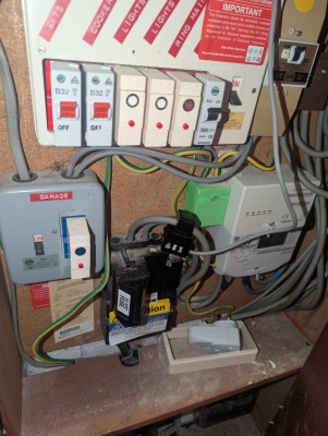

Do you have a picture of where the CT clamp is placed currently?

The arrow is pointing away from the black fuse box towards the grey box on a grey wire (that has a brown ring around it)
Photo of CT clamp
Photo of CT clamp

I don't think it makes a difference, but the CT clamp for mine as placed after the meter (though that looks damn tight!)
I think in theory that it should work just the same as it's normally measuring the house flow to grid.
I see Henley blocks, but cannot of course see fully, do you have anything like a EVCP installed?
Octopus and Fox will never be equal in their value, but shouldn't be miles off, the CT clamp is nowhere near as accurate as your meter for sure.

The inverter went kaput regardless and this was replaced for new, but the issue still remained with the incorrect CT clamp readings. We noticed the house usage was going into negative more and more the solar increased.
We figured out it was a faulty CT clamp all along. Once unclipped, we spotted the house usage read the exact same as the solar generation. Easy to miss this, as with rubbish British weather (or you try fix it in the evening) the house generation would read 0w with the CT clamp off (which you'd think is normal, but because mine was faulty it's matching the solar which was 0w also at night or a rubbish cloudy day!)
Swapped CT clamp and everything read accurately
