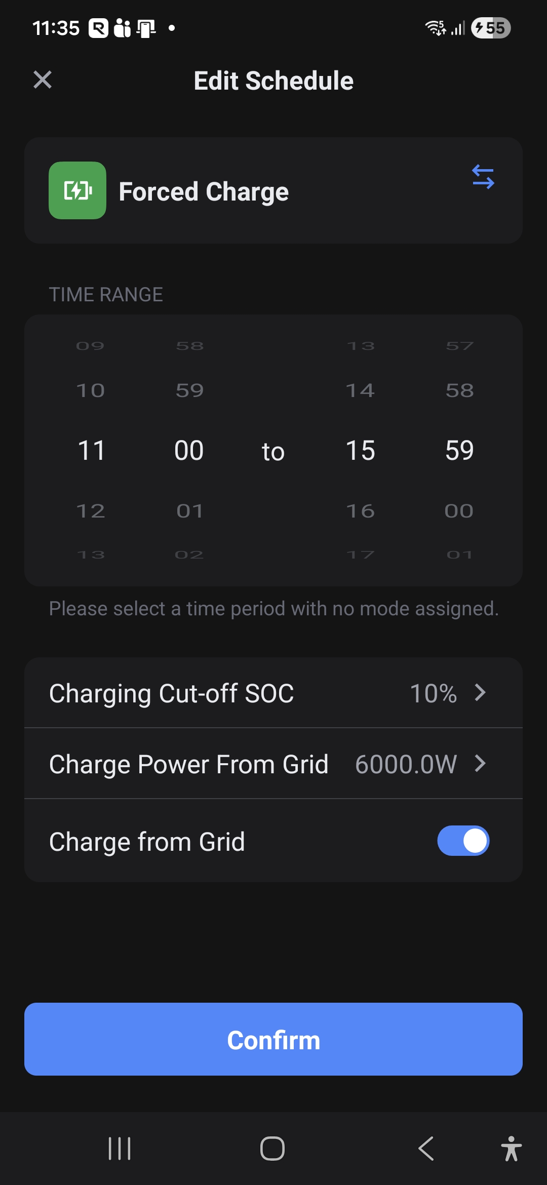

Force Charge setting disables solar when battery reaches 100%.
This is something that has frustrated me since I installed then unit. The latest FoxCloud2.0 App is significantly more intuitive, and is much simpler to setup. But it does not work the way I want.
I want to Force Charge in the daytime when the input rate in very low. Where I live, the only cheap electricity is 11:00-16:00. Another reason to do this is to supplement a small (probably inadequate) 6kW of panels.
Here is my problem - during the Force Charge, when SOC reaches 100% it essentially switches off the panels, and powers the load from the battery. I would prefer that the system falls back to Self-Use after the battery is full, so that it power the load from solar if available.
Example:
Forced charge is configured 11:00-16:00
11:00 - Forced charge starts. It is a sunny day. Battery is at 50%. Panels are producing 6kw. Solar goes mostly to Load. Grid goes mostly to Battery.
13:00 - It is still very sunny. Battery is at 100%. Panels are producing 0kw. Solar stops. Grid stops. Battery powers the load.
16:00 - Forced charge stops. It is still sunny. Battery is at 90%. Back to Self-Use. Solar powers the load.
Result - 13:00-16:00 I have lost 3 hours of solar production

I have this issue. Especially for winter, I need to charge the battery because solar doesn't fill it up. However, once filled, i would like it to go back to using solar self use.
What it actually does on forced charge: Fill battery, clip PV generation and use grid.
What i would like: use pv for home load, remainder of pv charge and draw from grid to charge during to time of use.
Master is 1.39
Manager is 1.24
App says up to date
8kW panels
H3 smart 10kW
32kwh batt
Master is 1.39
Manager is 1.24
App says up to date
8kW panels
H3 smart 10kW
32kwh batt
