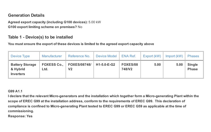

In the hand over pack there is this from UK Power Networks. Is this the information I need?
Re: Fox App 2.2.0 Quick Settings Question
For compliance, yes you should set your export to 5kW (5000W in your App settings)
Given you have 12 panels of 445W, you will barely breach the 5kW limit (happens fairly rarely in Summer due to heat) so you are fairly ok.
Import has no limit from what I see for you, apart from the main supply fuse, so either 100A x 230V = 23000W, or 63A x 230V = 14490W
