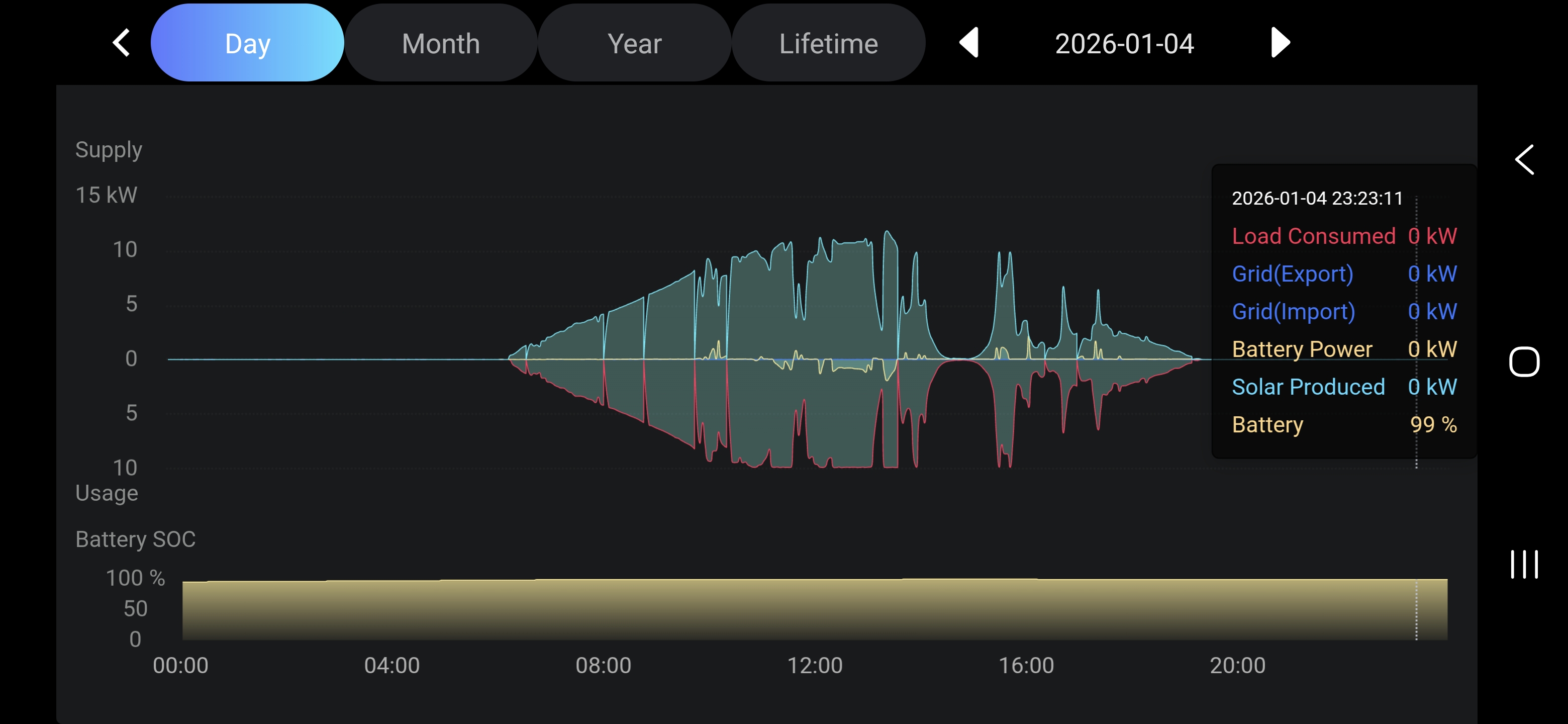

Can you post the graph from the app (swipe left on home page), it shows solar, battery, grid use and that will help show what is happening.
Helpful if you could also share any settings you have for minSoc, battery reserve and if you have any charge periods set.

I have attached a screenshot from few days ago.

Ok thanks, I don't think the problem is the CT facing the wrong way - it's not reading any grid power and just showing solar generation as load which is what you would expect if there was no CT fitted.
You may just want to get your installer back as it could be a setting or wiring fault,
