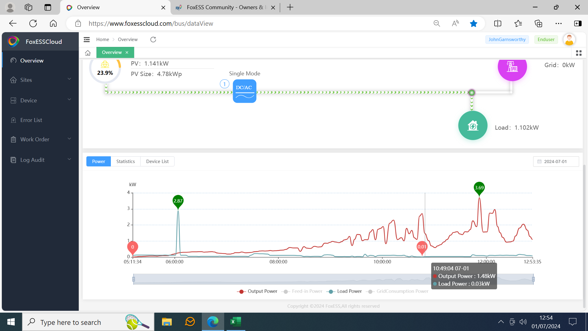

						Hello
I'm new to this forum after having had solar panels installed on my roof recently and downloading the app to my laptop as I don't have a smartphone.
The app was working perfectly well until a couple of days ago since when the Live Status is showing all the energy going to Load  Power and none to the Grid.    This is clearly incorrect as confirmed by the bottom "Overview" line chart.
Any advice on what the problem is and how I might rectify it would be welcome.  I'm not a tecchie by the way !!!

Hi, would you be able to screen shot the screens you are talking about and post them below so we can see what you are seeing.
Off the top of my head, this is usually indicative of the CT clamp being installed the wrong way round or in the wrong place, but if you can post those images it will help diagnose it - if you could also say which inverter it is solar only (F/S series), Hybrid with batteries (H/KH series).

The inverter is solar only.
A screenshot is below showing output power and load in the bottom chart.
