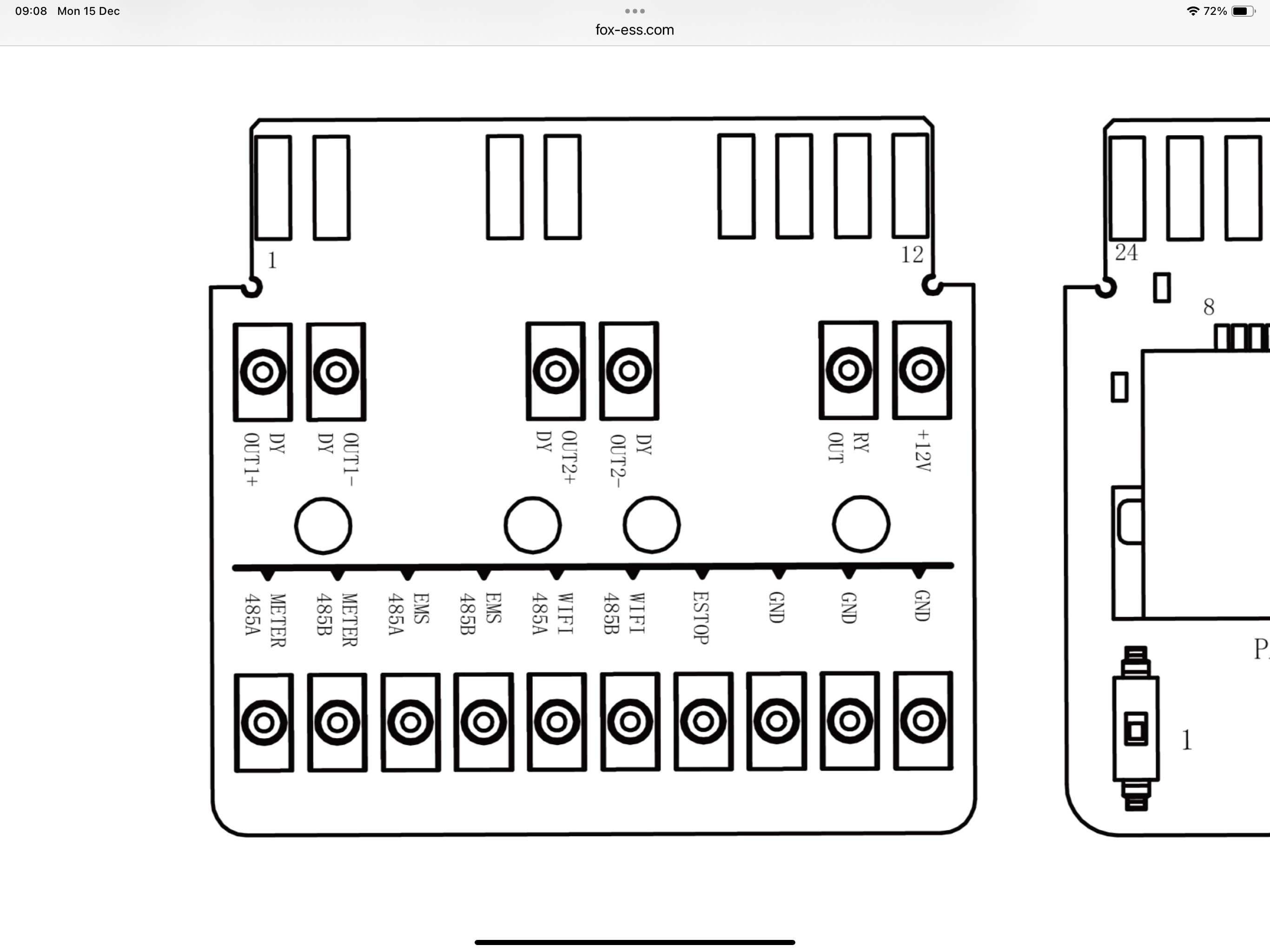

Additionally, regarding the RS485 interface on my inverter, I am unable to see or identify any exposed RS485 ports. I would appreciate clarification on whether RS485 communication is supported on this model, and if so, where the port is located or how it should be accessed.

I’ve heard several H3 Smart users say that it does support direct LAN connection but have no direct experience myself, I think there are a few open issues on the integration where this has been mentioned, you might be better asking there.
On the RS485 connections, these are exposed on the COM connector as EMS485A & B

Re: H3-15.0-Smart inverter Home Assistant with LAN port
padashow123 wrote: ↑Mon Dec 15, 2025 8:54 am Com connector already used by installer for monitoring.
The Com connector has a multitude of connections as well as the meter connection point
