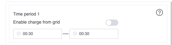

From looking at videos it looks like the battery settings interface has changed since this advice was given - with no documentation that I can find to explain what each thing does (when I hover over/click on the "?", either get get an empty box or a toast that pops up saying NOTICE and nothing else). Does anyone know the equivalent I would need to do with this:
Screenshot 2023-07-31 at 10.28.16.png (10.66 KiB) Viewed 66258 times
I'm on Octopus Go so will be charging car between 00:30 and 04:30 when it needs it, but for the summer it seems I'll be getting enough solar to last on batteries overnight, unless they're drained by the car.
Thanks in advance!

https://www.foxesscommunity.com/viewtopic.php?t=337
Long story short, they've changed the interface but you can still stop the battery from discharging overnight while charging an EV
