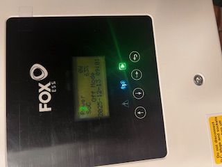

Ive also just noticed that the inverter panel says OFF Mode but i cant get it on so now the house is just running from grid missing the batteries and the force charge used for flux has stopped working it appears that the link between the inverter and the load in the house is missing on the app where it shows the energy flow i am not sure how to resolve this if anyone can advise please it would be welcomed

ive noticed now it says on inverter off mode says Active Err 1/1 safetyinvalid advice please

Inverter just says OFF MODE

Press and hold the ‘enter’ key (3rd from left) - when it says Start ?, release and press it again - the inverter should start up.

ImageImageImageHi ive tried all the resetting instructions a ssoon as there is power to the inverter it comes up with the message Active Err 1/1 Safety Invalid ive tried to boot the inverter without batteries and its still the same Image

Hmm, and you have confirmed that the safety is set correctly im Settings > 0000 > Feature > Safety - should be G98_UK
Failing that, I would contact either your installer or Fox support (in the v2 app you select Me, Contact Us, Support) - possibly a firmware update will help, but it could be because of a hardware fault and it needs some remote diagnostic.

Fox ESS H1-3.6 kW showing Active Err 1/1 Safety Invalid.
Occurred immediately after force charge.
Grid code is UK G98.
Error appears immediately on boot.
Please re-push G98 safety profile / re-commission inverter.
