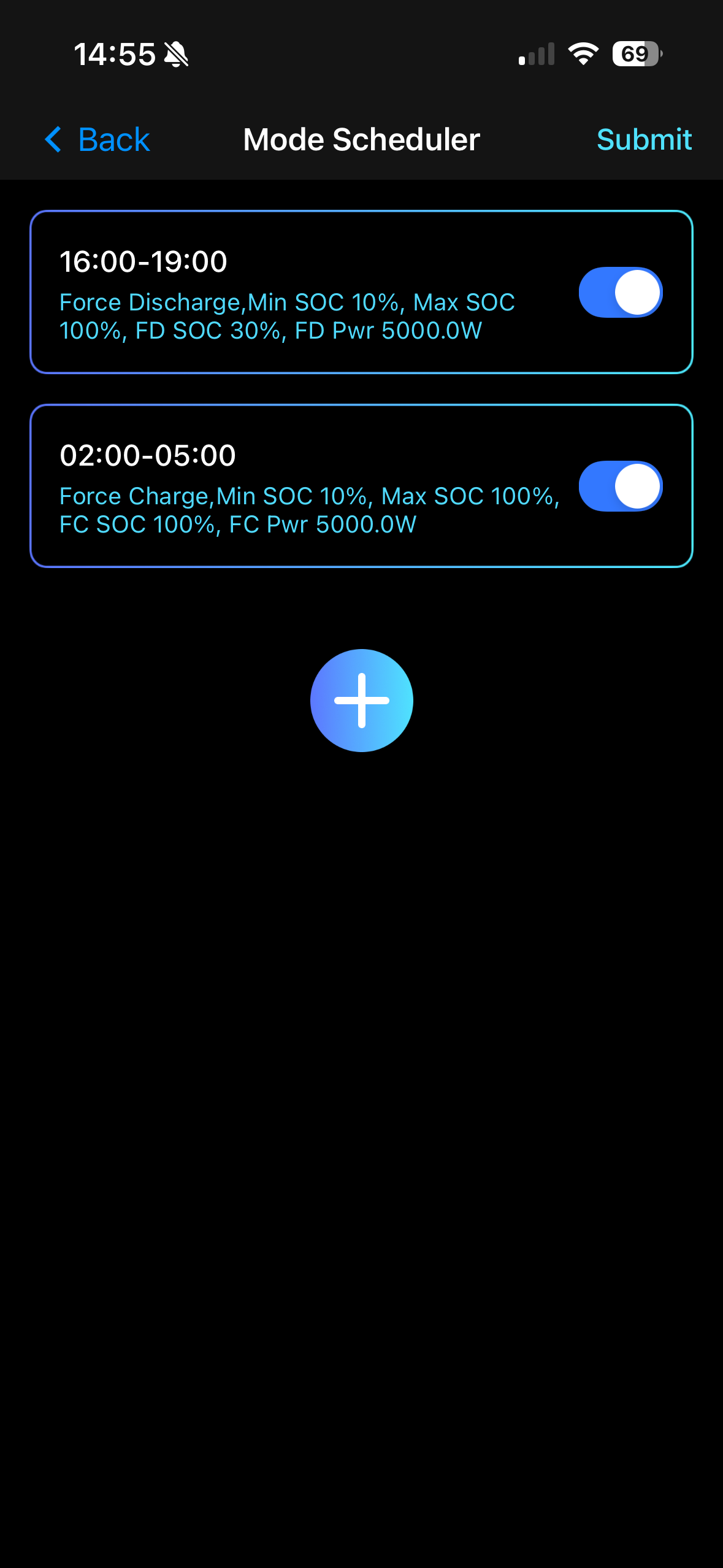

Re: Unable to discharge when I want
Thanks. Can you confirm that I have both charge and discharge settings correct now.
Gary
Yes both are set correctly, the only comment to make is the schedules end on the 59th second of the time, so you would be more precise ending at 18:59 and 04:59 but it’s only a minute.
So just to confirm what each is doing,
The Force Discharge will discharge the battery, starting at 16:00 and ending at 19:00(:59), and will cut off should the battery soc drop to 30% - discharging at a rate of 5000 watts.
The Force Charge will charge the battery, starting at 02:00 and ending at 05:00(:59), charging to 100% - at a maximum rate of 5000 watts.

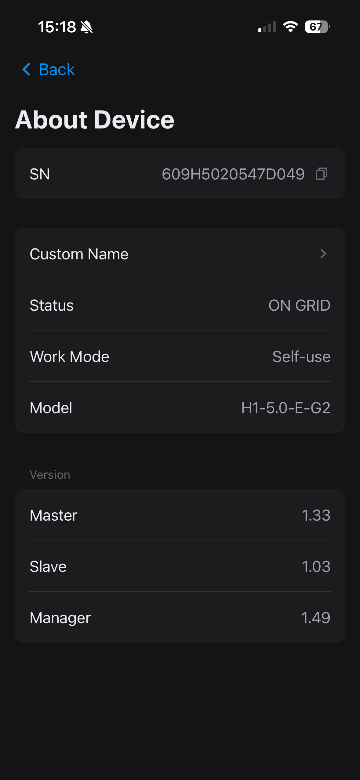

You don’t mention your inverter model and there have been a couple of issues on the KH series with firmware 1.52 in that the force discharging would not return to self use when it hits FDSoC, 1.55 firmware fixes this.
Thanks, The Inverter info attached.

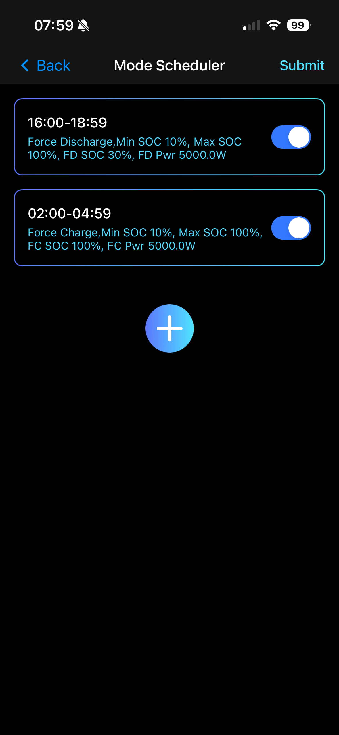

Did not work, started to discharge at 5am this morning! Any other ideas?
When you say "started to discharge at 5am:" do you mean it started to discharge at full rate (5KW) or just enough to cover the load?

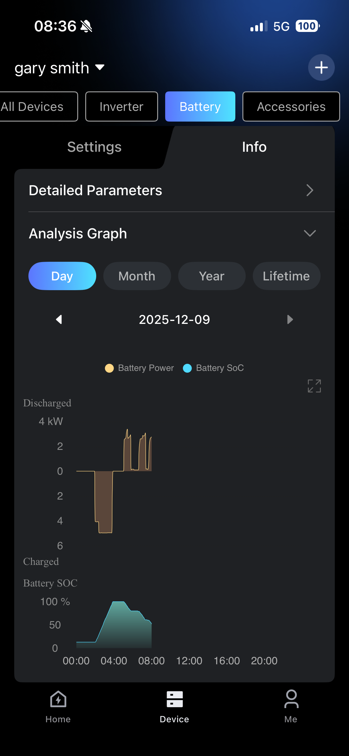

Please see graph

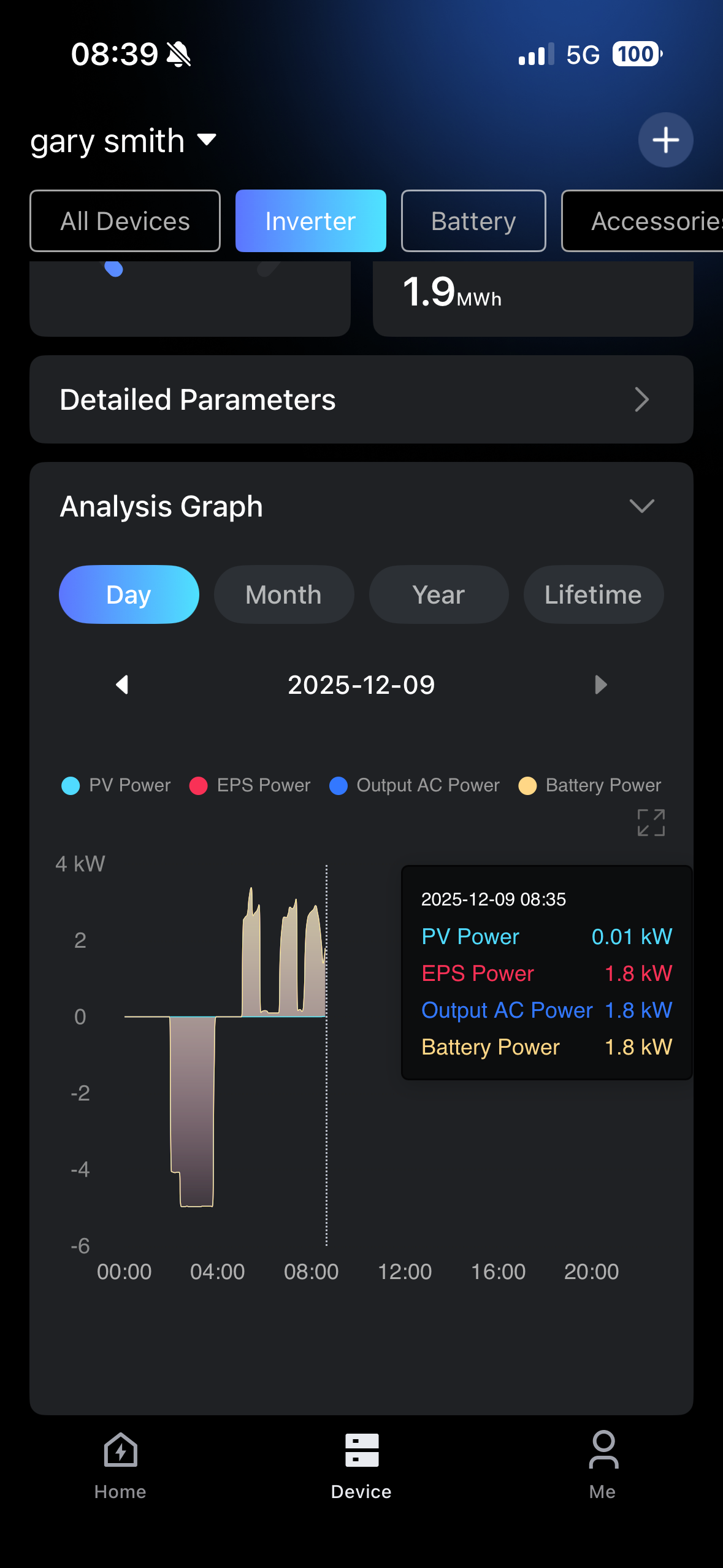

Inverter graph below, previous was the battery.

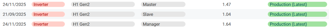

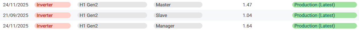

What should the latest firmware be for my inverter H1-5.0-E-G2
garysmith38 wrote: Tue Dec 09, 2025 8:50 am What should the latest firmware be for my inverter H1-5.0-E-G2
You can check here
viewtopic.php?t=1927
H1 G2
garysmith38 wrote: Tue Dec 09, 2025 8:39 am Inverter graph below, previous was the battery.
The inverter will be set in Self Use mode at 5am and so the batteries will meet any house load which is its normal operation.
What exactly are you trying to achieve?, normally it would be to run the house off battery and dump any excess to the grid at the higher flux rate.
If you don’t want to use the battery at all, use grid power at the standard rate and then dump the battery at the high export tariff, that may not be possible (depending on your firmware).
If that is what you are trying to do you would need to set the workmode to ‘Backup’ at 5am until 15:59 (again this depends if your firmware supports it)

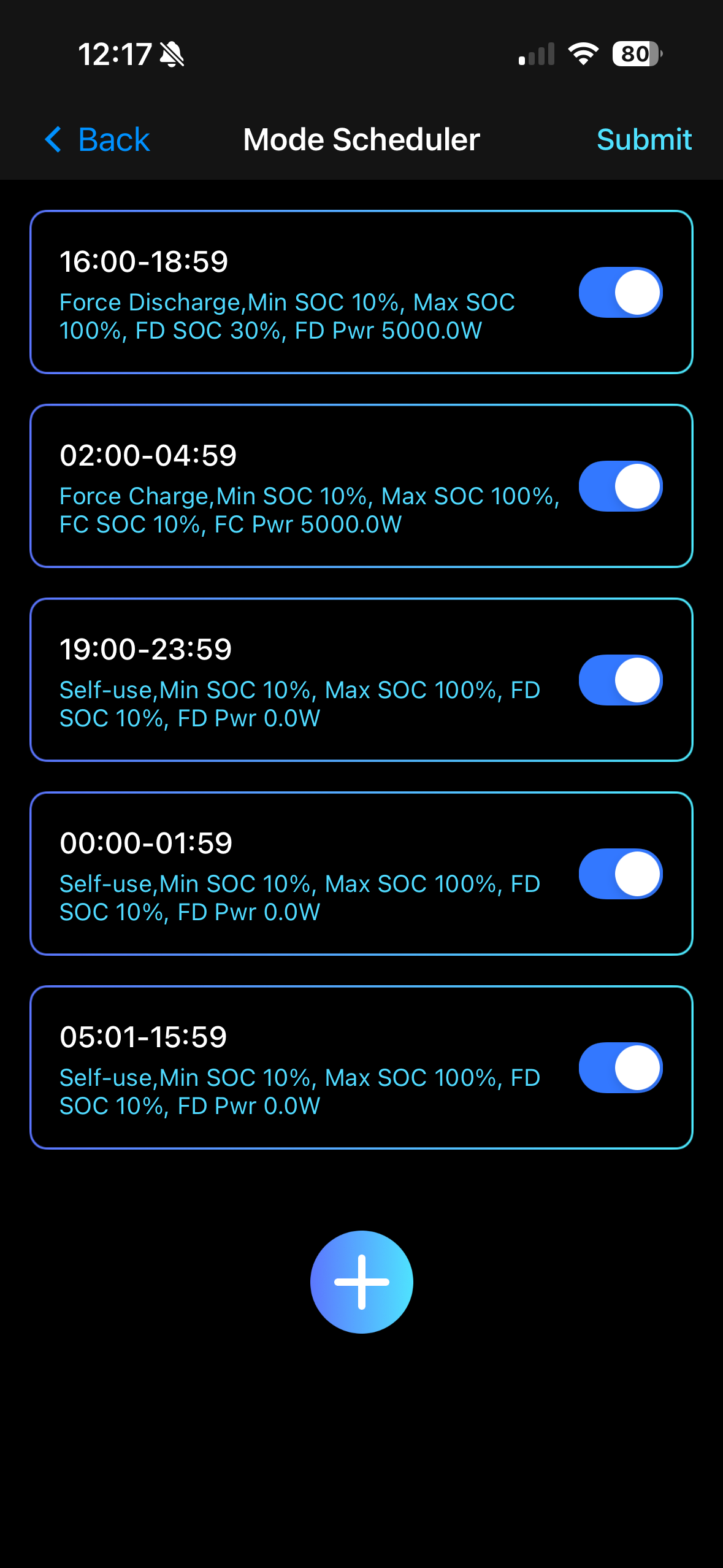

Well, it still not worked!! I am stumped. Screenshots attached of setup.
The inverter is now in "self use" mode which means it will be discharging and supplying the house load (up to the inverter power rating) which is what it is supposed to do.
If you want to stop this from happening you need to add a schedule with the mode set to "Backup" from 05:00-15:49
