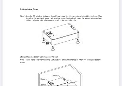

If you are trying to turn it on with no grid or pv, you need to do a black start i.e. press the power button, then press and hold the b-start button for 10 seconds.
(Don’t forget the last bottom battery waterproof connector is fitted)

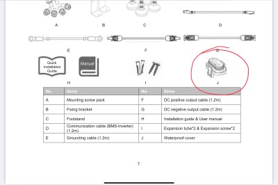

Hey Dave what is the bottom battery waterproof connector?
Re: FOX EQ4800 L9 not turning on during commissioning
It looks like this, and covers up the battery inter-connect on the bottom battery.
OOHHH ok thanks mate, unfortunately it didnt come in the box with battery ill contact fox to get it. Much appreciate the help thanks.
