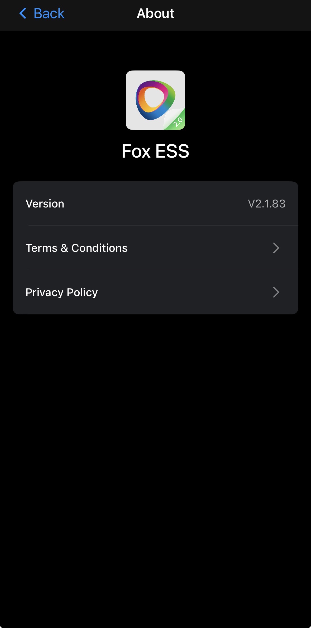

I recently posted about our battery not charging at specific times past midnight, that was resolved by Fox performing a firmware update. Has been working now for the week and charging between 2-5am.
This morning I noticed nothing charged, is this regular performance of the fox mode scheduler? It’s very disappointing, I wouldn’t have let the supplier install this system if I’d known it would be this flaky. We haven’t touched the app or system since the firmware update, is there anything that would suddenly cause it to stop working overnight again?
Firmware version of the app included for reference.
