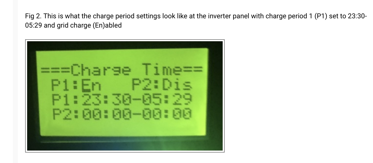

If you have schedules running, you won't be able to set a charge period on the inverter panel, and you can't reset your schedules without a cloud connection... yep well thought out I know. If you don't have schedules running, you go into the inverter Settings, Work Mode, Charge Time and you will see the 2 charge periods P1/P2, you set the time for a period then set the switch to say 'En' (enabled). (see attached settings for 23:30 to 05:29 note you can set it to run through midnight at the inverter panel)
