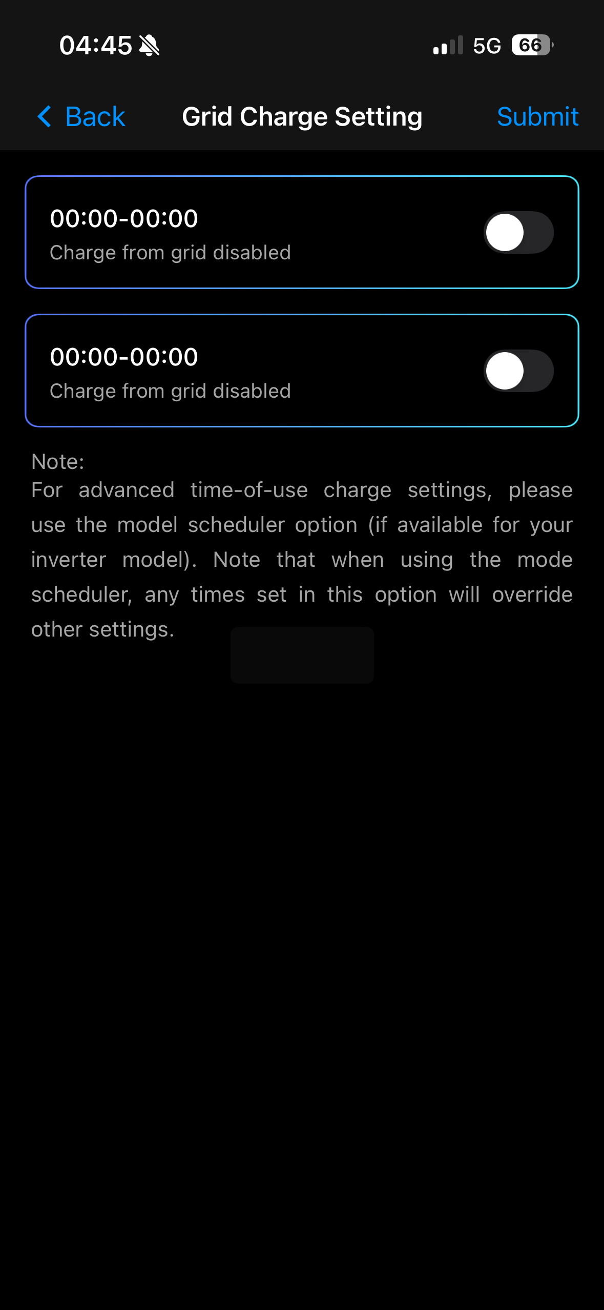

Yea def no grid charge enabled. I’ve read about it happening to others but no real fix yet. Might have to update firmware.

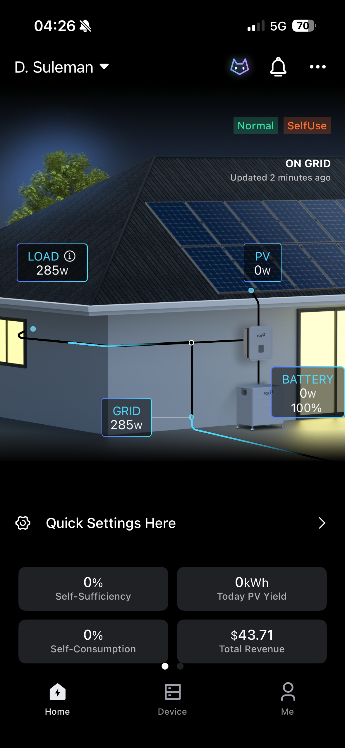

These are my current settings and you can see full battery and still pulling from grid.

And then as soon as there’s a tiny amount of PV coming through, the battery stays doing something but not all of the load. I’m stumped :(

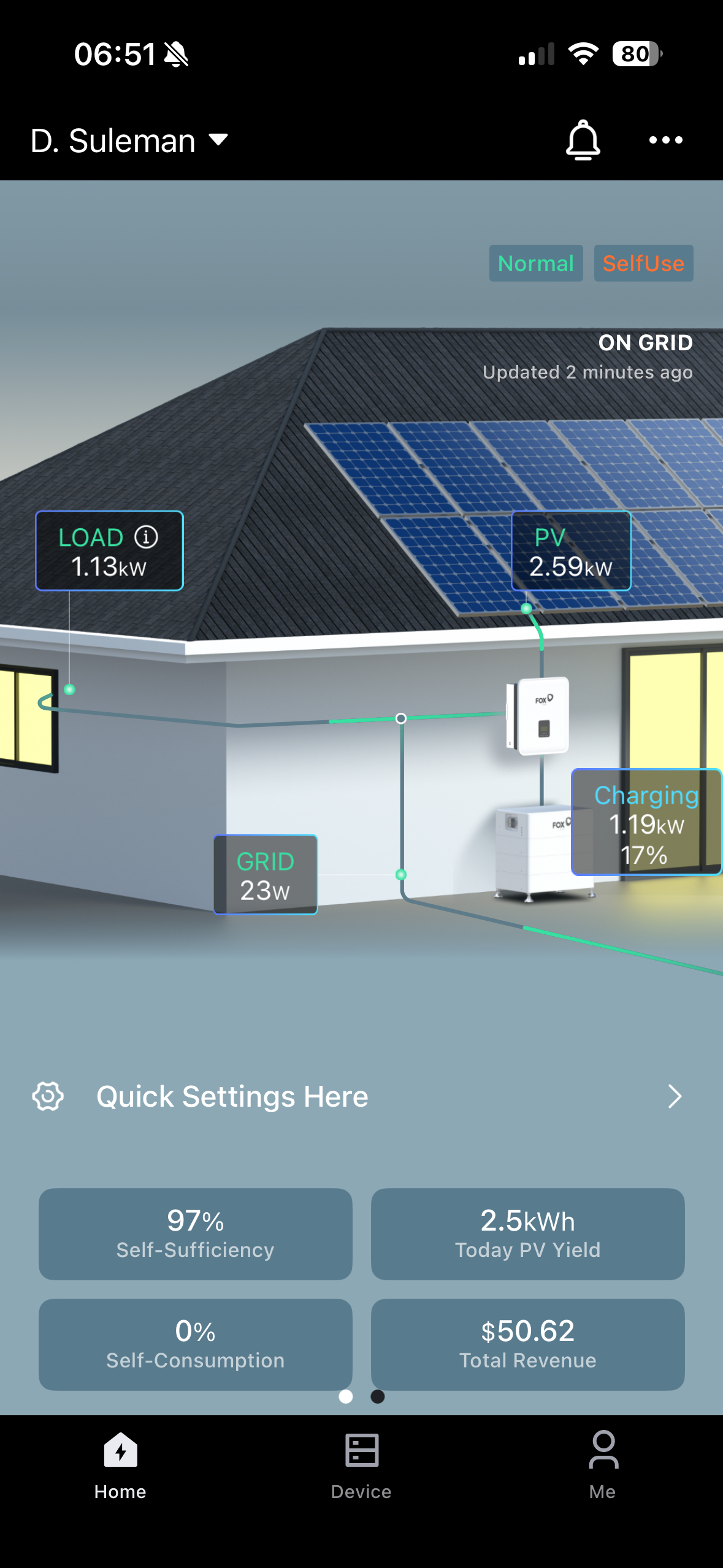

Just one question. See image below… why would 270w be missing… numbers don’t add up from what solar is feeding to house and charging battery? That 23w is grid incoming which I can’t change.

Your missing energy might be what your Inverter is using itself, or losses from converting DC to AC (for house load)
